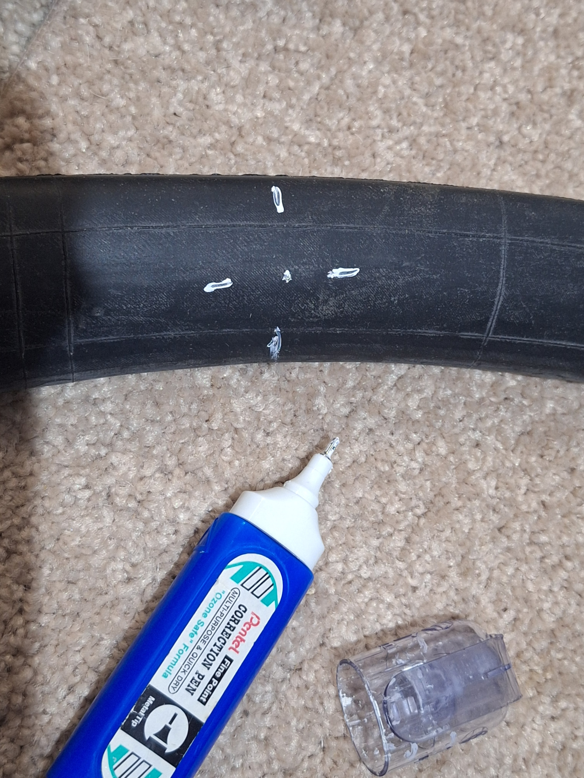

This is my hack. You never lose the hole if you use a twink pen to make a cross-hair. I usually dry the glue over a heater and only pump up the next day. Obviously in the field its different but if I was on a very big trip and was concerned I’d put in my spare tube and patch the holed one incase I needed it. Eg, missed the piece of glass or thorn stuck in the tire. Usually I pump up the holed tube to find where the hole is to check that location on the tire anyway.
I’ve always used a sharpie to do crosshairs in the same way. Although darker-black doesn’t stand out as well against a butyl innertubes, it’s enough for keeping track of the hole after abrading the area and applying vulcanizing fluid. I just use them to make sure I center the patch over the puncture. But your process with white is a nice extra layer of redundancy.

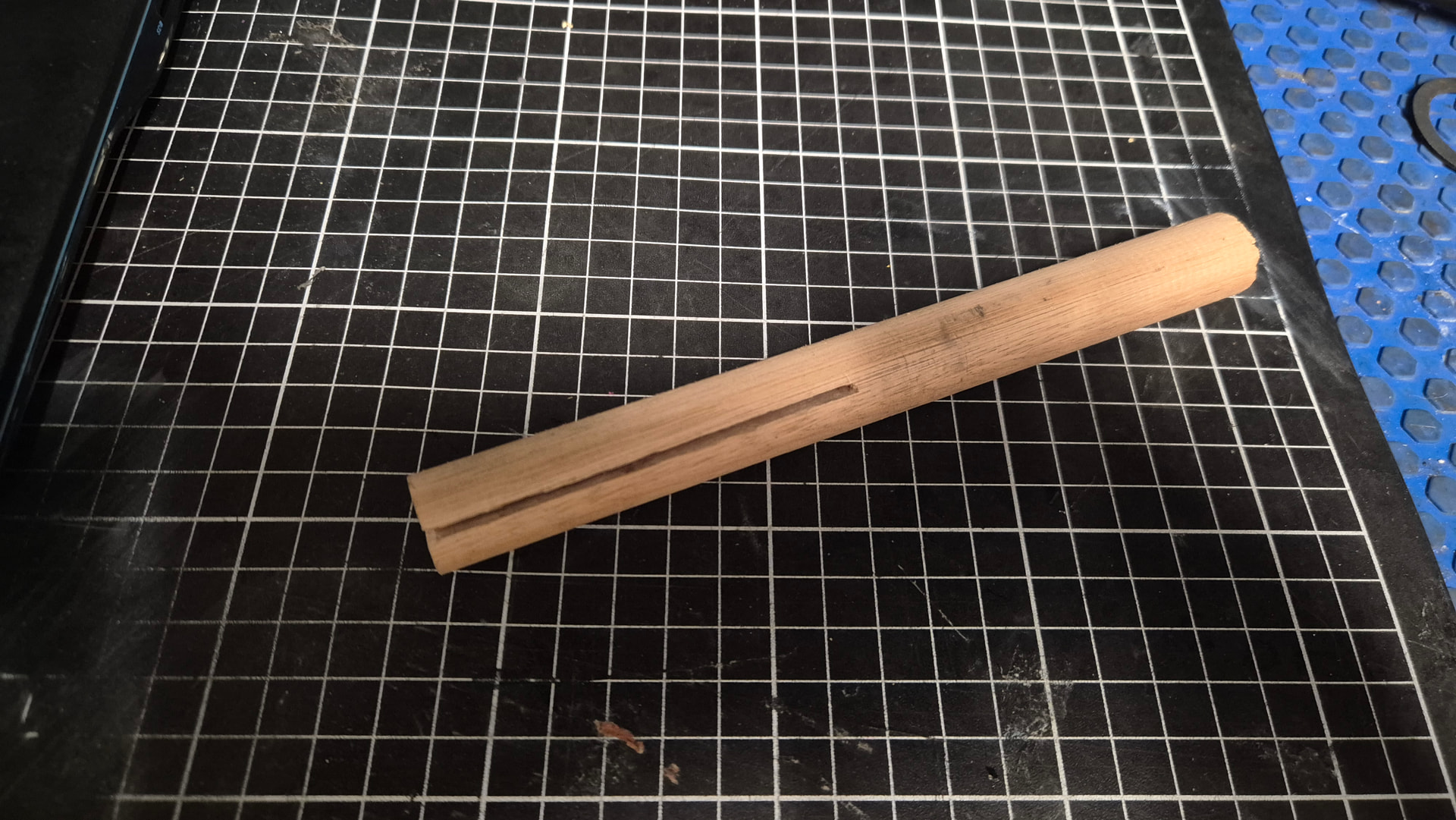

My other trick is to use a wooden dowel with a slit cut into it to use as a mandrel to roll the tube up on. I hang the tube from a hook then fit the dowel at the other end and apply gentle tension while rolling the tube up. It’s really effective in squeezing out all the air and getting the tube back to its original packed size.
Just so I understand, it’s TPU tubes that you’re cutting up for this purpose? And what size dowel is your rolling-up mandrel? I like that idea.

Dowel is 19mm but that’s just cause I had some lying around.
