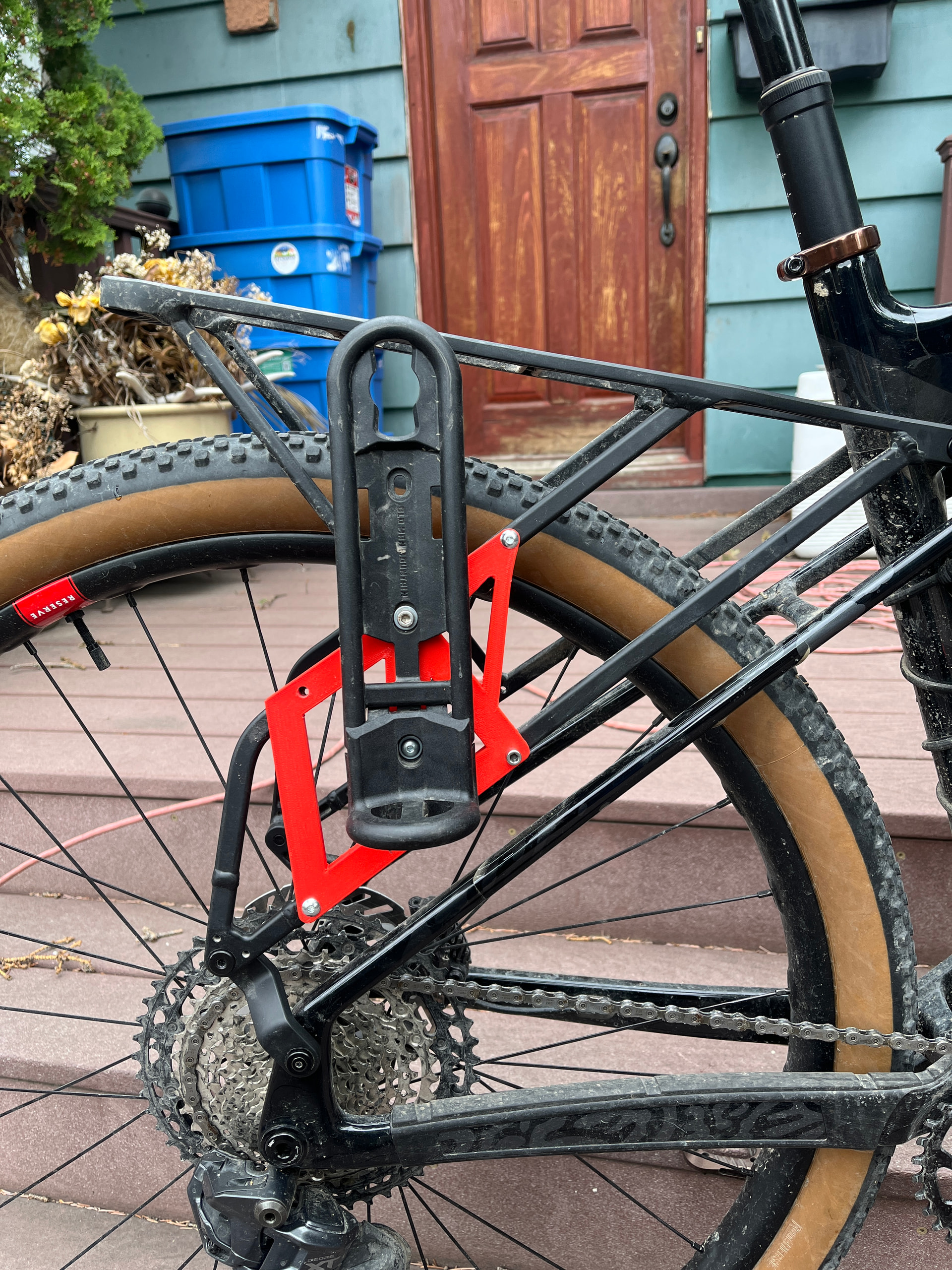

After putting more time in on the bike, much of it loaded for bikepacking, I have become increasingly annoyed at the slanty rack and how my bags brush my heels or knees. I am going to either adapt the rack to mount the 3-pack mount micro-panniers upright, or ditch the trek rack in favour of a OMM Elkhorn rack. Has anyone come up with a better solution?
Good to know. Just bought some small panniers and, while I have yet to use them, I am concerned about them interfering with my feet, due to the design of the rear rack.

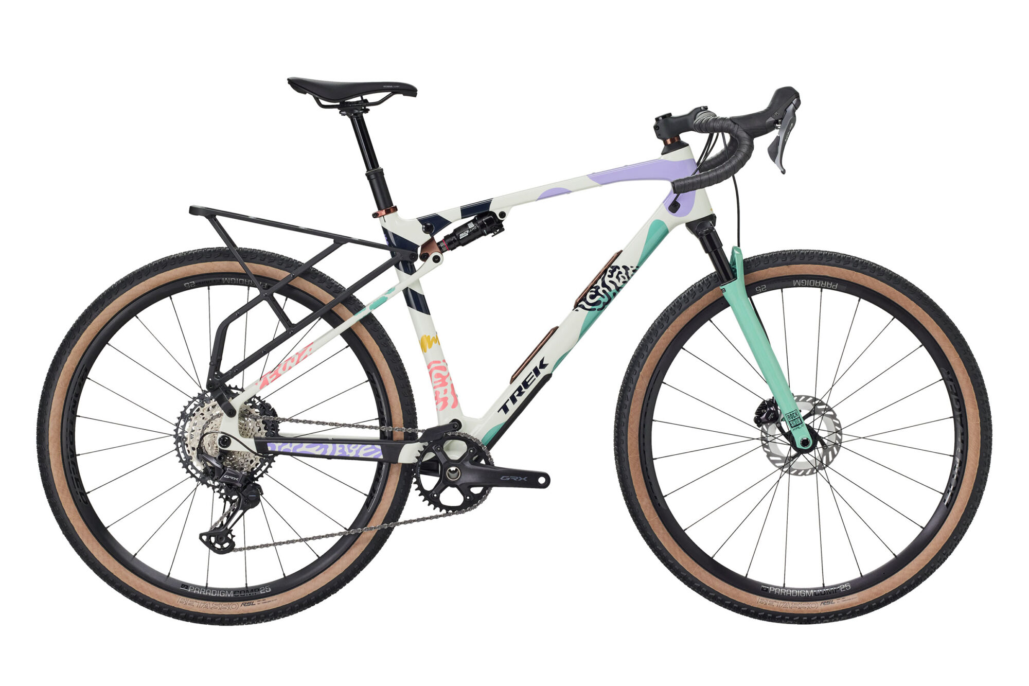

I got an SL7 in the multi-colored colorway, and it’s a blast! Used it on many a day-trip as well as bikepacking the Kokopelli Trail.
I made several mods to mine… but top three pieces of advice:
  1. Ditch the stock tires, as they’re ridiculuously slow. Vittoria Peyote XC Race do much better for me.
  2. Consider sizing down. I’m 179cm and got an ML, but had to shrink the cranks to 165, the stem to 60, the bars to 44, and slam the seat post down. It fits me quite well now, though!
  3. If you get the colorful colorway, swap in Trek’s lavendar bar tape. Dunno why Trek didn’t do this themselves!
FWIW, I didn’t have any heel-strike issues using the rack with mini-panniers. Perhaps that’s an advantage of the larger frame?
Enjoy!
Mine is a size L, and I have small feet, so I was pretty surprised that I have such a heel strike issue.
I got my local 3d printer guy to make me a prototype upright bag mounting frame.
I ordered some with the 3rd mount of laser-cut aluminum
