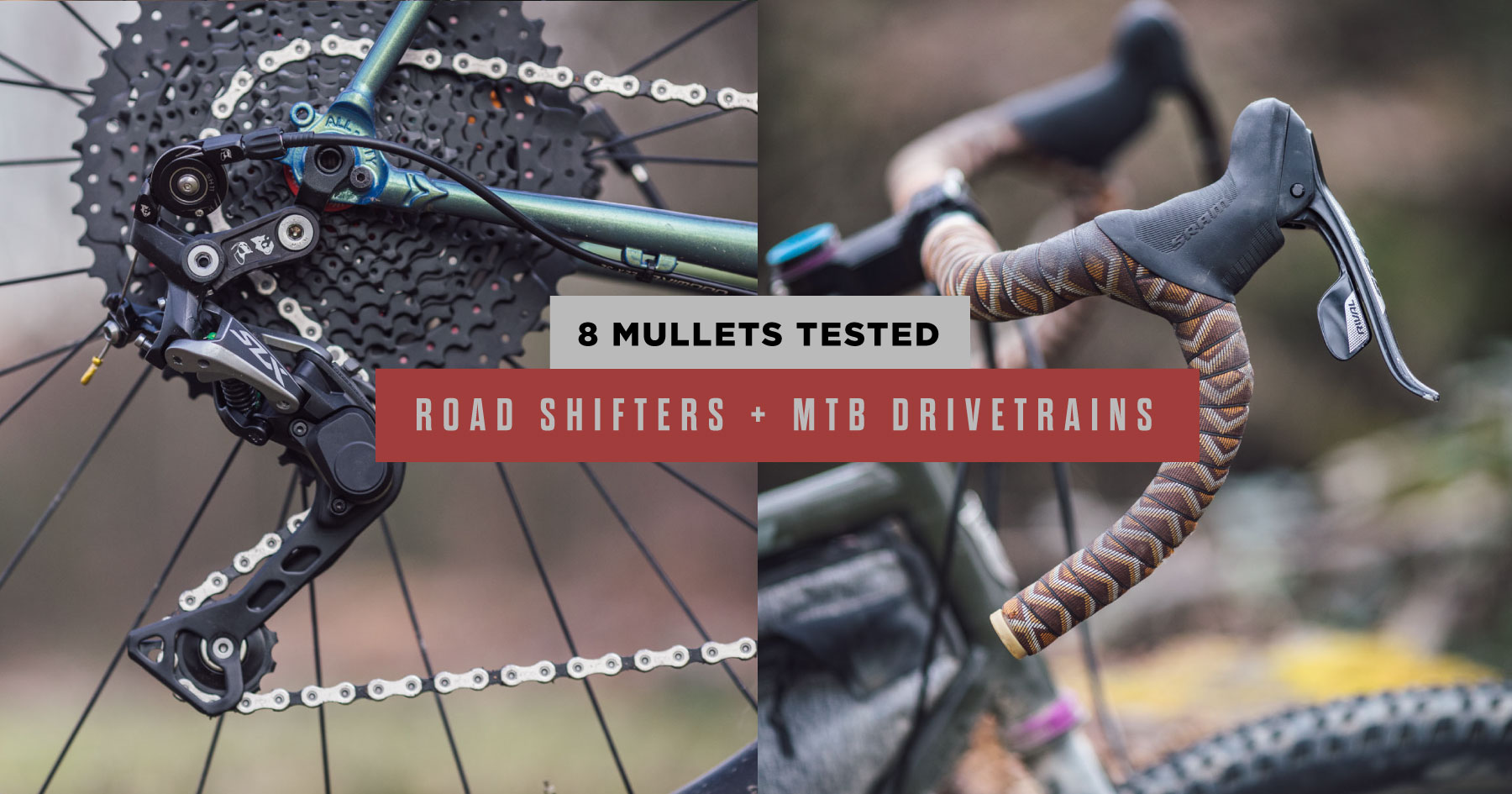

I realise I’m late to the party but I’d recommend checking bikepacking.com for gearing options. I have bookmarked this page because this is something I’m constantly wishing to improve.
