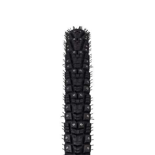

I have this in 38mm

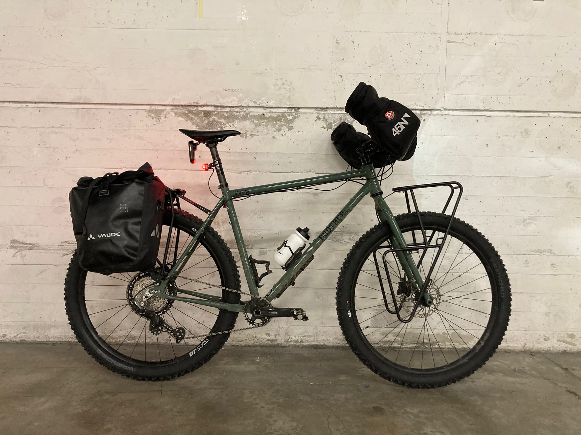

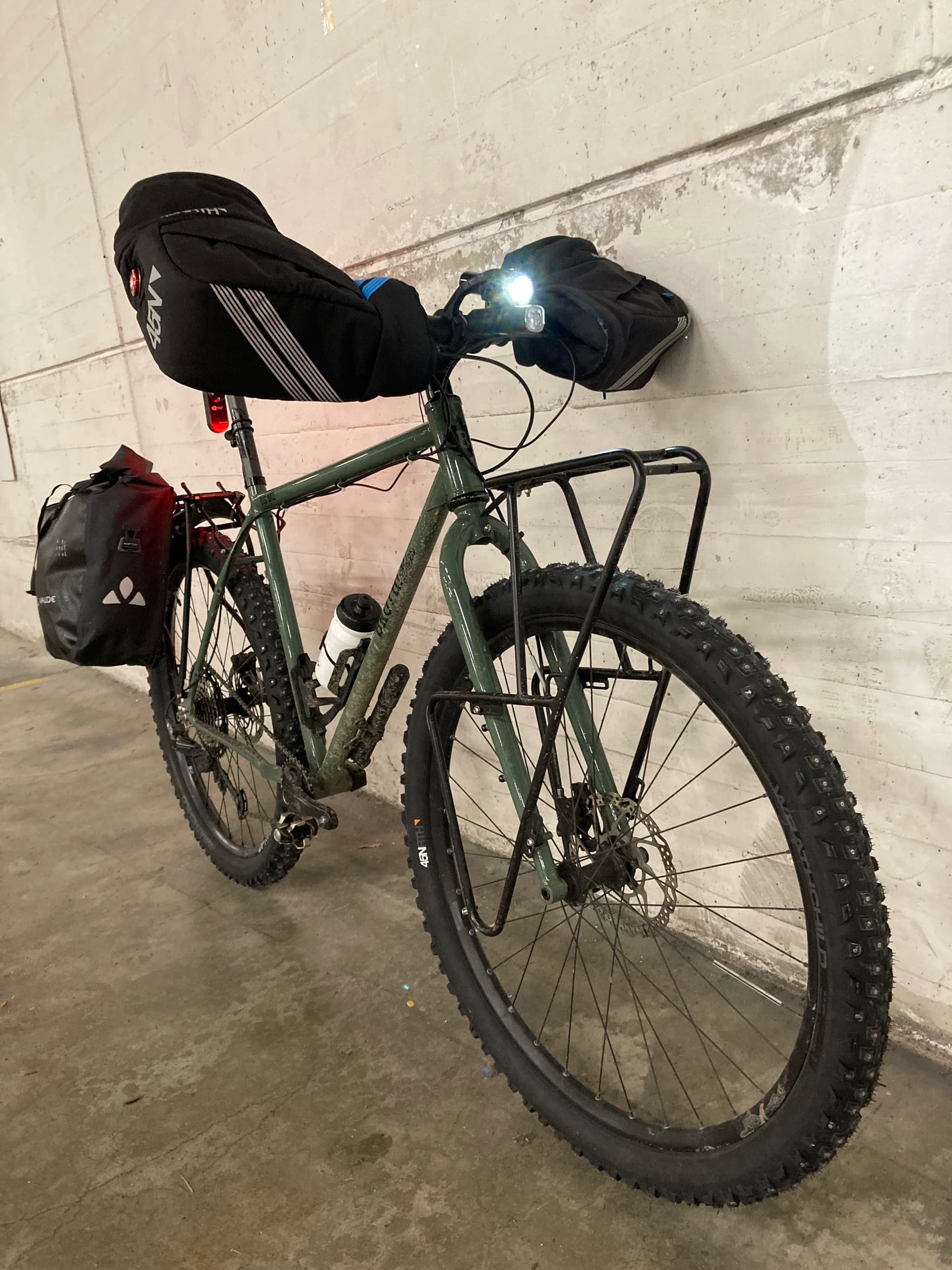

On my side, I am either using Continental Spike Winter 240 studs 42mm, Schwalbe Ice Spiker Pro 2.25" or 45NRTH Wrathchild in 2.6”. The faster are the Schwalbe, by far, and the less noisy the Contis. The Schwalbe are very scary when cornering, it’s why I switched to the 45NRTH, which also allowed me to use only one wheelset for all winter, instead of two. I got more robustness issues with the Contis, notably in the hook region. But I did once a descent in 10cm of fresh snow and they were ok. On the flat with the same snow, there was no traction. The 45NRTH gives a sacrĂ© look at my MTB, I love it!
