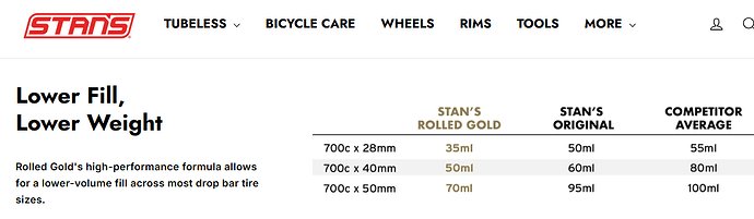

I have not tried the new Rolled Gold, but I have been monitoring the release. I do like what I have heard. The lighter part I think comes from the ability (Stan’s information) to use less sealant and thus a lighter rotating mass. My predominate interest is promoted ability to seal punctures at higher road tire pressures.
Stan’s website outlines their lower fill, lower weight scenario.
Thanks. I have a crappy old measuring thing which I can barely read accurately. So 15ml difference is not that relevant to me. But maybe that just means like for like it has more hole clogging power. Maybe!
