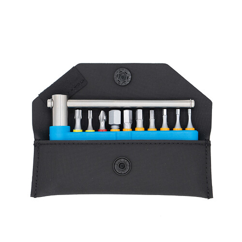

Big fan of the Daysaver tool, that’s the easy choice (some people find the bits too fiddly but I haven’t had an issue). You can get the tool in a nice case with some extras from Milkit as the Hassle’off. It’s designed to be mounted on the bike, but slides really nicely into a saddle bag.

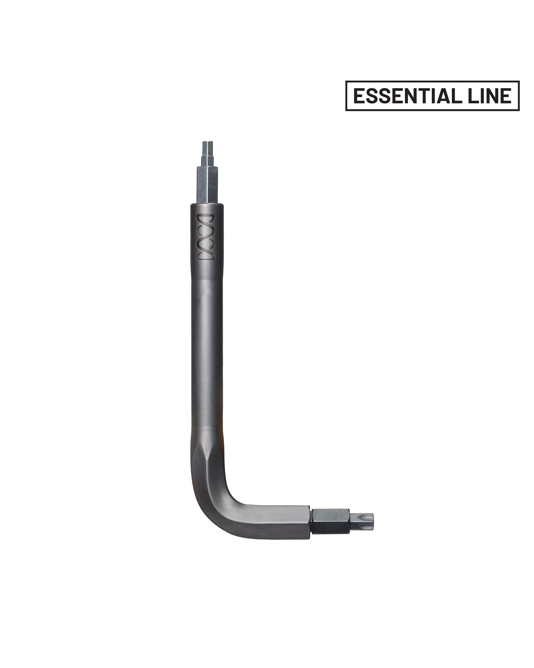

Plenty of good suggestions here. The SpurCycle Tool and DaySaver are excellent if you want all sizes covered without compromising the 6mm demand.

I actually did not have the daysaver on my radar. I have heard about it before several times and even had the web shop open at one point but when thinking about this it did not come to my mind.
Probably the best solution for this specific use case, and about the same dimensions as a standard hex key but with extra functionality.
