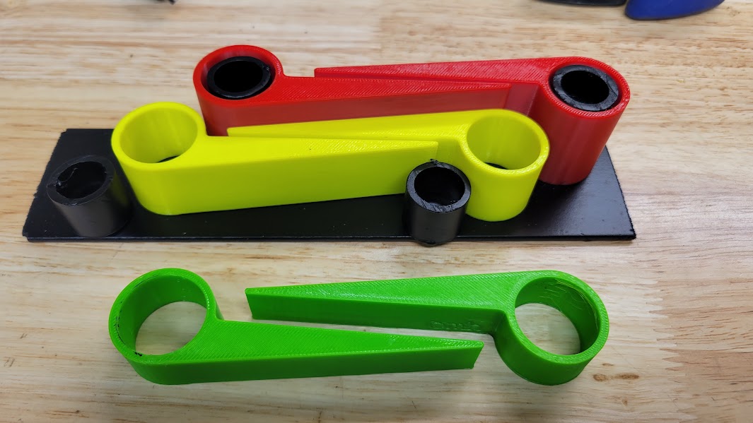

· Pad spreader – I usually use Pedro’s tire tools, but I have some nice tools for this.

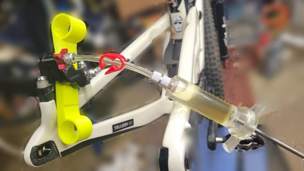

For general press-back of pistons, I tend to use the Pedro’s yellow plastic tire levers, but for a full-bleed I prefer to start with a full piston press to flush with caliper using these. They work great!

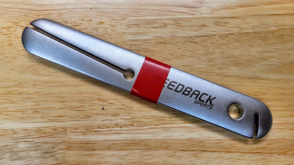

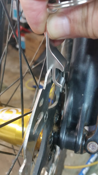

Generally speaking, I use the FeedBack rotor tool (below) or Knipex smooth jawed pliers, but I have used a bottle opener and alcohol cleaned crescent wrench to true rotors.
I don’t think I have ever own any set of disc brake systems - SRAM Force, Shimano Ultegra/Dura-Ace - in which the rotors did not go out of true. That said, I routinely service my wife’s commuter bike and the “cheapo” rotors on her bike are still straight as an arrow :man_shrugging:
