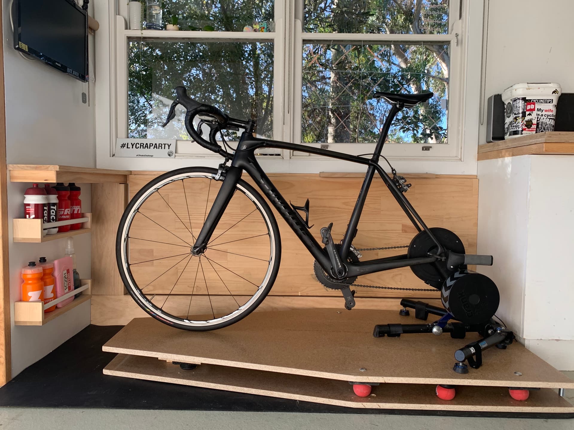

RIP CT content - but certainly a fun project. I even did a 10k vEveresting on that thing!
I cobbled one together from scraps and used the inflatable balls for springs. It greatly increased my comfort but doesn’t feel natural when standing. Once this one wears out, or I’m tired of looking at it, I’ll upgrade to better version.

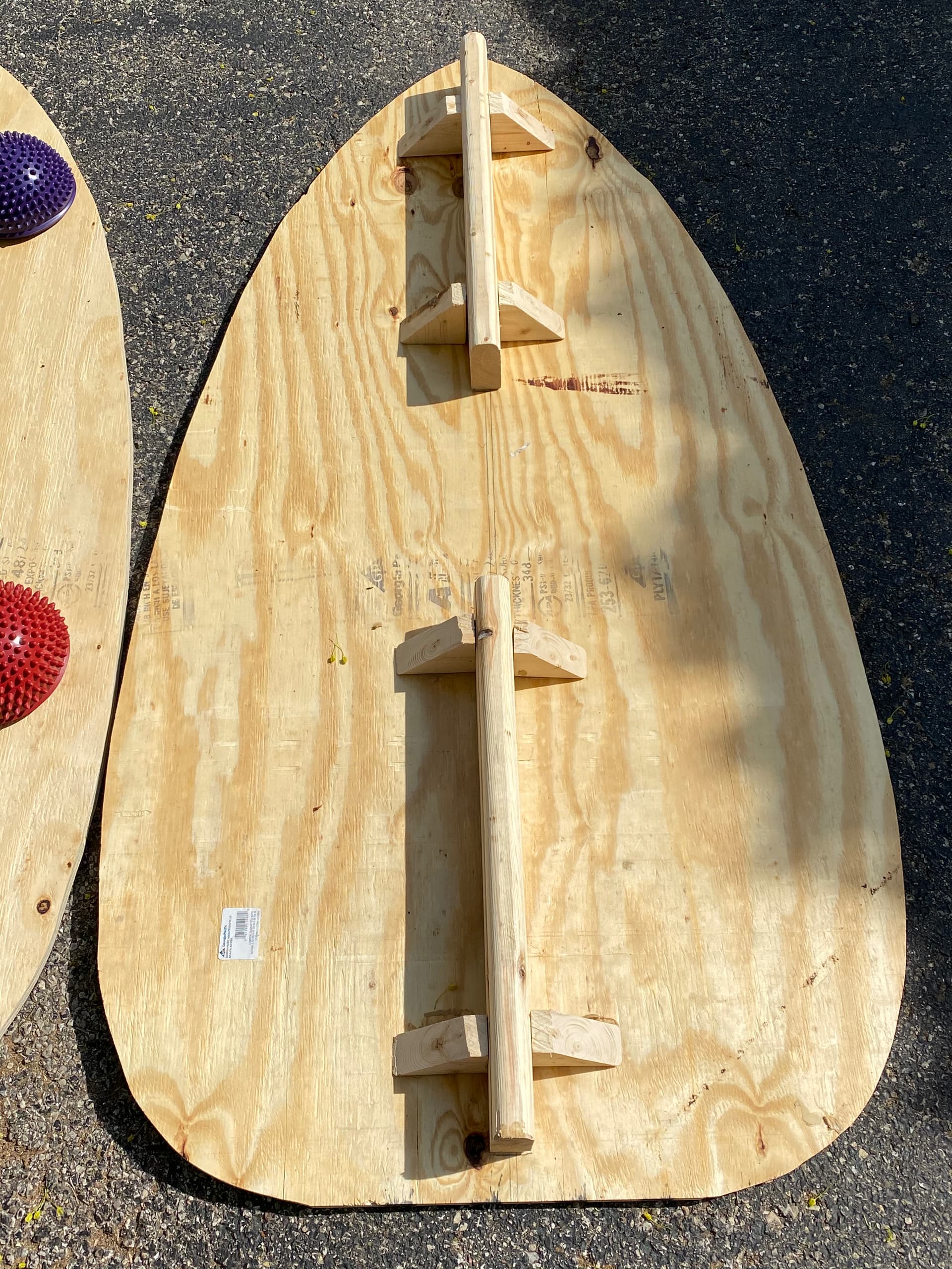

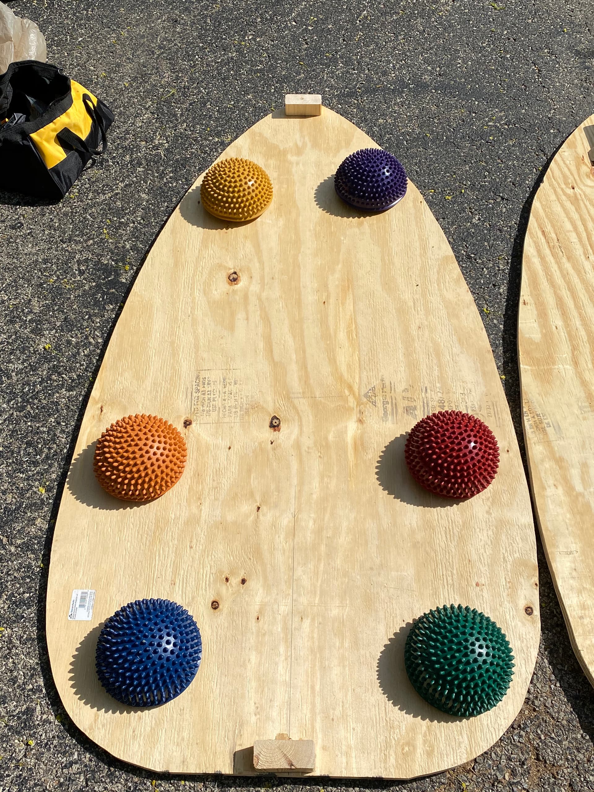

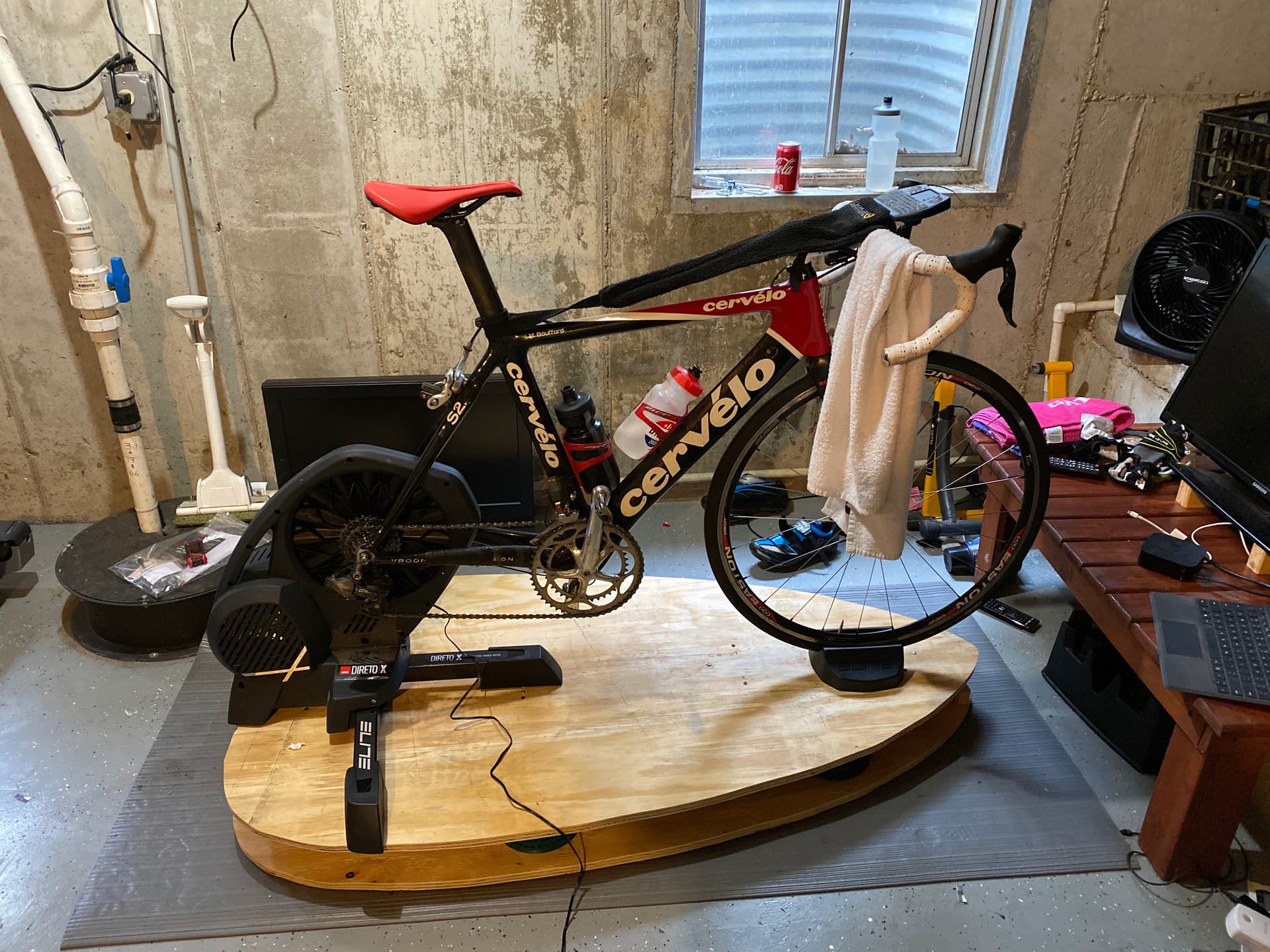

Here is what I did a few years ago….very simple construction. Matching platforms and a 2x4 down the middle of the top platform, rounded on the bottom. Mini-Bosu balls for the suspension.
It feels a bit wonky out of the saddle, but you get used to it pretty quickly.
I have since added some of the foam mat material, cut-to-fit, on the top of the platform.
