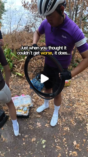

Pawls themselves are not a common replacement item. What is the problem with them?
Yikes!
Well…that’s certainly a valid reason.
The fact that any hubs are designed in such a way that they can fall apart under their own weight if you’re not careful is a bit mind boggling tbh
Do these have encaps with a tiny retainer “O” ring in the cap?
Sometimes these get lost or wiped out when cleaning.
If not, what is supposed to retain the cap? There should be something and it might be missing?
Yeah it’s just the friction from an o ring, common design, but if you’re not careful, the weight of a large cassette can cause it to pull off, as evidenced in the video I linked.
