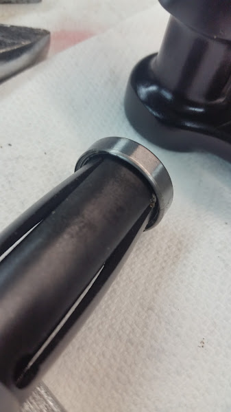

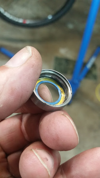

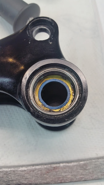

Yikes! I have had smaller bearings that the inner race & bearings had separated leaving on the outer race installed in the bearing pocket. These were obviously smaller than a headset race, so finding a blind puller large enough to do the trick?
These would be easy perhaps compared to yours?
