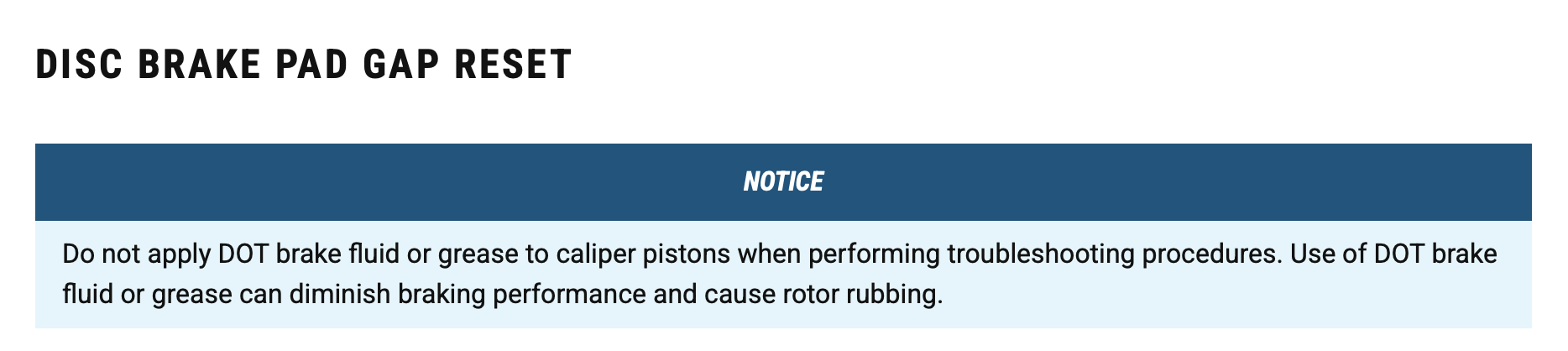

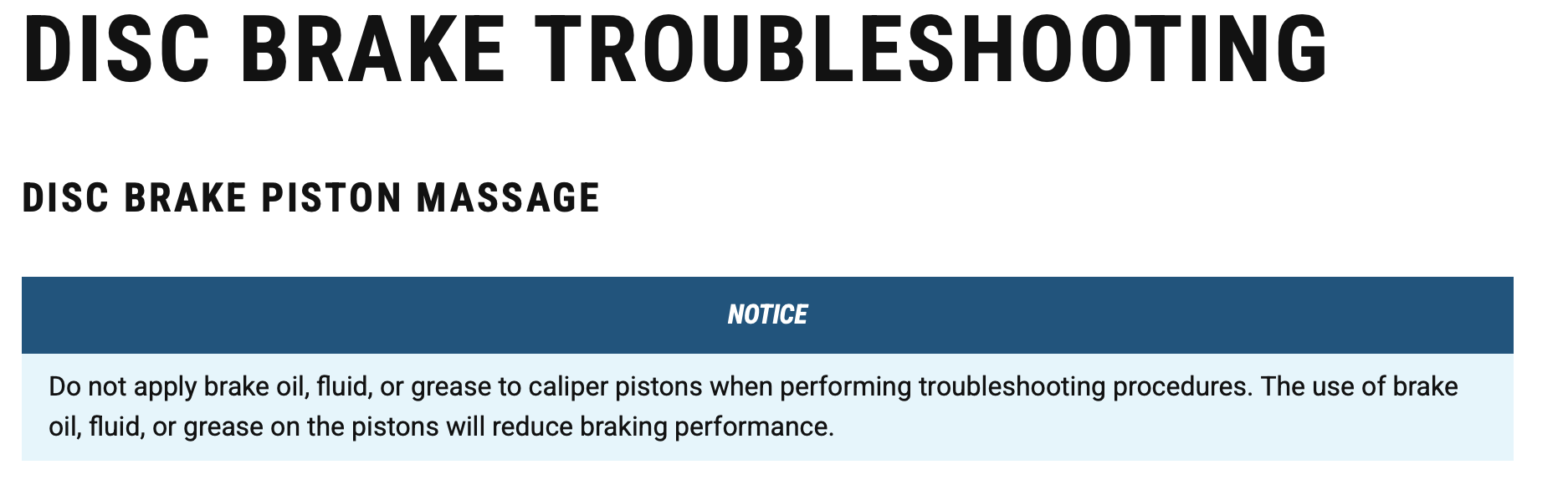

That’s not recommended. As a matter of fact, SRAM specifically tells you not to do it.
Yep, I’m aware. I tried SRAM’s exact massage procedure a few times without any change. When it didn’t fix the issue, I looked elsewhere and found the recommendation about putting a little DOT fluid around the outside of the pistons.

There was a good visualization on instagram about how brakes need friction between the piston and seal to work properly. lubing the pistons inhibits this and can cause the pistons to not retract. The most common cause of sticky pistons is just gunk or corrosion between the piston and caliper body. Sometimes its impossible to get at the gunk without disassembling the caliper. At that point, it is better to replace the pistons and seals anyway.

Install with new seals amd NEVER EVER lube the pistons as lubing them does provoke exactly the kind of behavior you want to get rid of.
To follow up on this thread if anyone reads it in the future - the advice was right, the pistons weren’t retracting due to my putting DOT grease on them. I rebuilt the caliper using only DOT fluid as indicated in the SRAM service manual and they work perfectly now.
