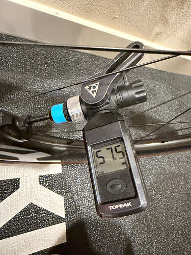

@jakub I like the Topeak Shuttle Digital Gauge, it is secured by a lock lever, it can be used together with a floor pump. One can buy spare rubber kits.
@Simon2 I somehow dislike battery-eating gauges. Also, can I mount clik adapter to Topeak?
I bought it 6 months ago, still the same CR2032, so it’s not so bad, plus the battery cells are much cheaper when bought in a big package :wink:
It has a Schrader valve on the back, I threaded the Lezyne Schrader adapter on onto it. Clik adapter = Schwalbe clik valve? Idk if it’s compatible with this.
@Simon2 Should be okay since there is a threaded schrader option. :+1:
The threaded Schrader valve is an input only.
Well yea, but if I understood correctly, that’s what I am looking for. Just adding clik adapter to be able to measure clik-equipped tires.

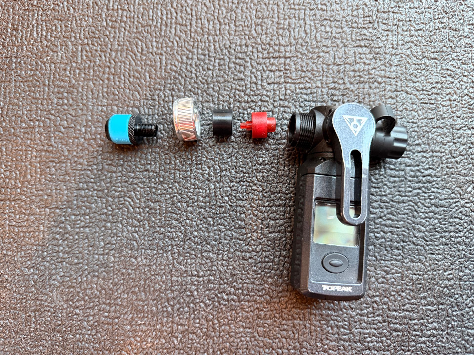

To attach the Clik pump head adapter to the Topeak Shuttle Gauge Digital, change the gauge to Schrader mode by switching the red valve adapter so that its pointy end is pointing away from the gauge, and flipping the rubber gasket such that its wider opening is away from the gauge. Even though the Clik pump head adapter does not thread onto the gauge, when the thumb lock lever is engaged, the Clik pump head adapter does not come off the gauge.

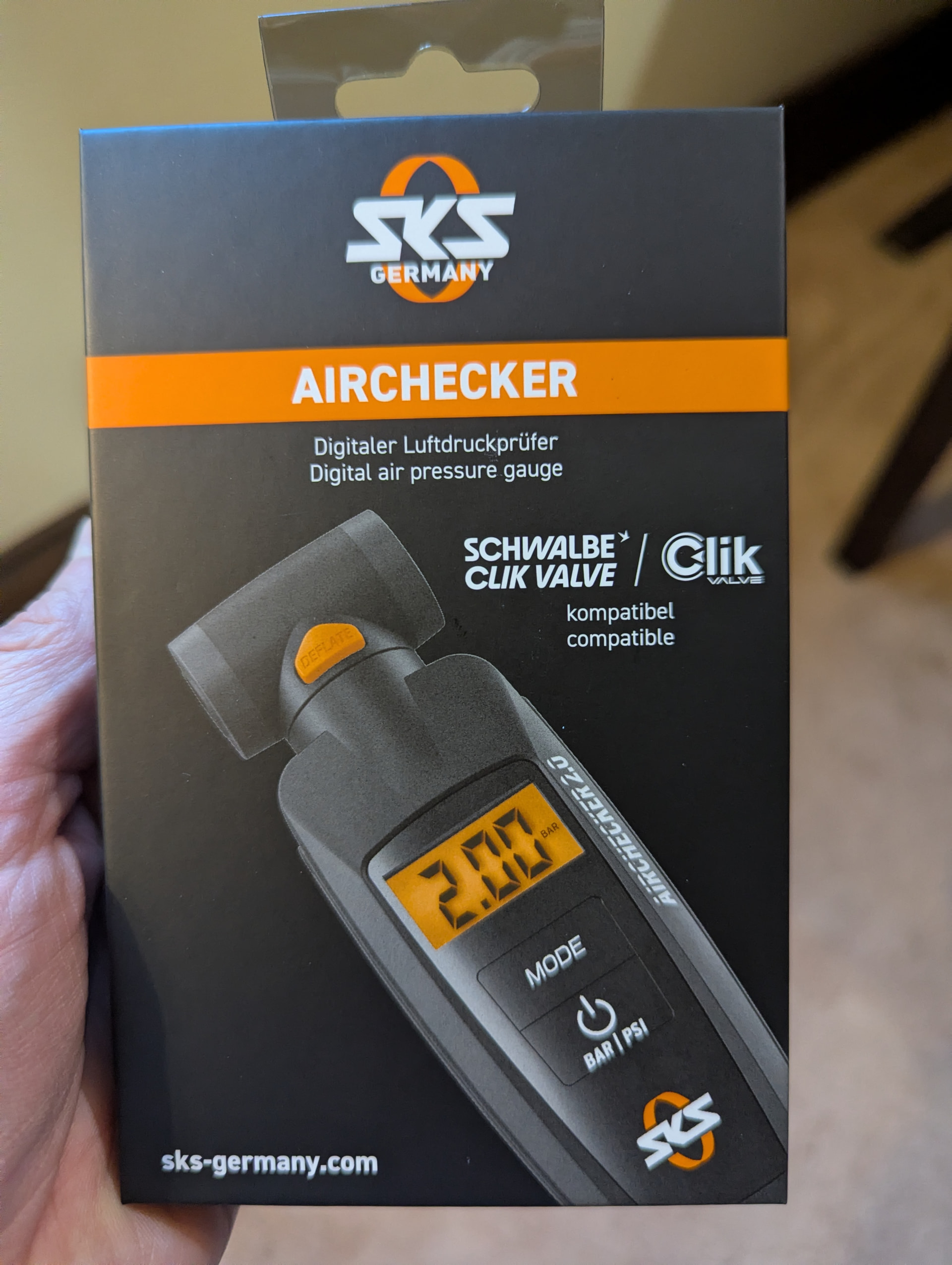

I’ve always been happy with an SKS Air Checker, but lost mine. Just received anl new one, version 2.0,
and noticed on the package that it is Clik valve compatible.
Have you tried it, Andy? I just read this review and it left me confused…
ā€œIt is good enough for presta and Schrader valve too. I bought it for clik valve based on description, but it’s less good for that. I like the click valve because it’s easy to connect. This is not easy. You have to push a rubber sleeve on it. It’s even less good in the cold. It’s a disappointment to meā€
I don’t have any Clik valves, so no I haven’t, I just needed a replacement for the one I had lost, without realising I was getting the version 2.0
