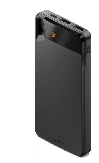

Cygnett seems easily available here at a decent price. Does your look something like that?
You need a low current draw power bank. On some models you need to put it into that mode, others will switch automatically over. The Nitecore NB1000 Gen 3 switches automatically. Bonus - will also charge smart watches, earbuds etc.

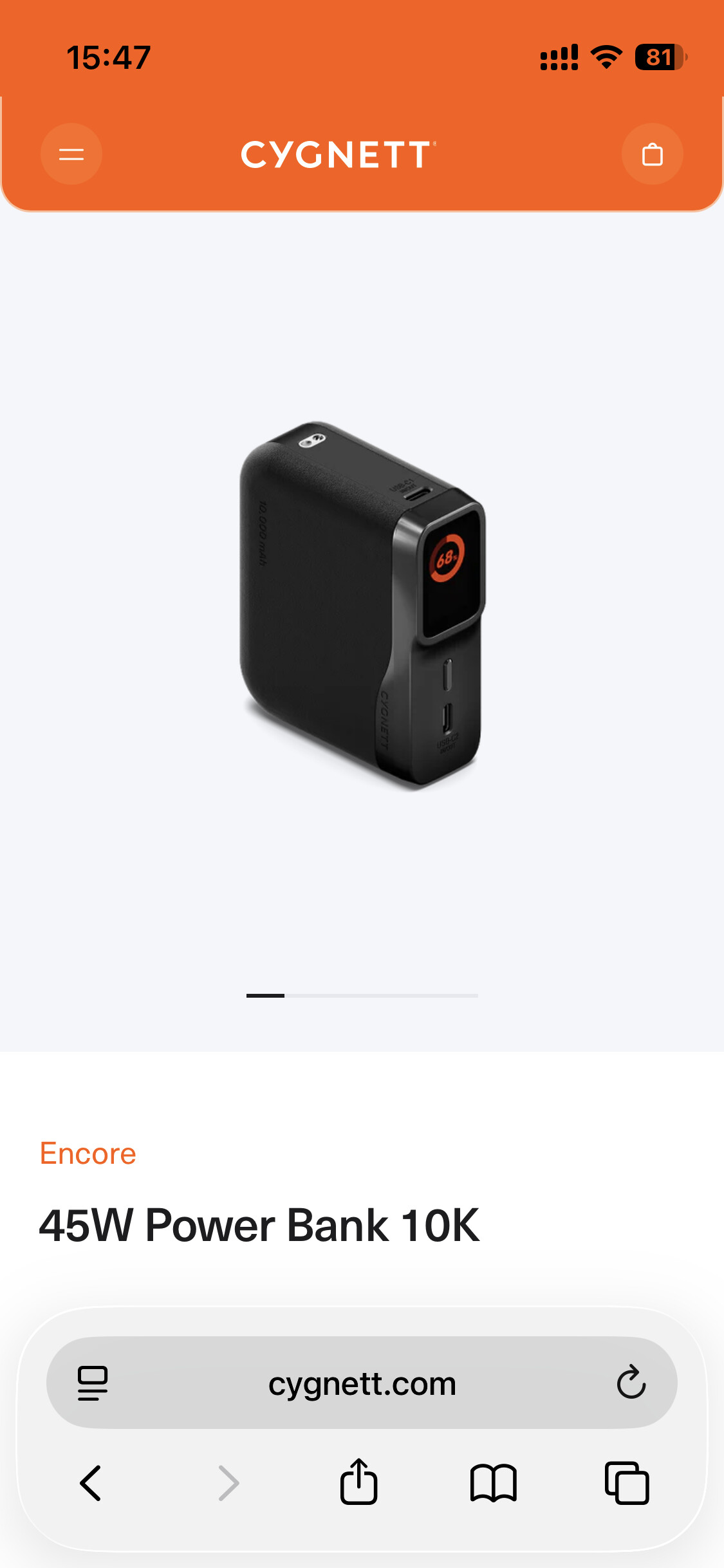

Mine looks like this. An Encore model. It seems to turn the display off but keeps charging low draw devices until they’re full.
I’ve watched my Garmin watch and rear light complete their charge cycle then stop flashing.
it doesn’t have any over ride modes or anything but seems to work.

The Cygnett Encore has 2 x USB-C and 1 x USB-A connections.
I’ve not used the USB-A connection though. It’s possible charging characteristics could be different for this port.
oh, it has, not sure why I did not realise, it’s written on the webpage. Probably influenced by the picture. Thanks! Then I’ll go for that one directly.
They do seem to have hidden it around the back like they’re ashamed of it.
