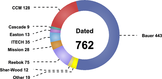

I don’t have a firm rule about when to replace my helmet so I was curious when this thread popped up. I’m a little suspicious when companies that want to sell me stuff ask me to buy something new every X years. So I just looked around on Google Scholar and the studies I found on helmet aging find no significant effect of age on impact performance:
On bike helmets:
https://asmedigitalcollection.asme.org/biomechanical/article-abstract/138/4/041005/371203/Age-Does-Not-Affect-the-Material-Properties-of
On other helmets:
https://journals.sagepub.com/doi/abs/10.1177/1754337115598723
I think it’s interesting to note that for both of the studies on bicycle helmets, I could not find any studies that showed the opposite or argued against their findings.
Of course, this is just two studies, helmets aren’t that expensive and you only have one head and brain. So this isn’t to say people shouldn’t replace their helmets.
