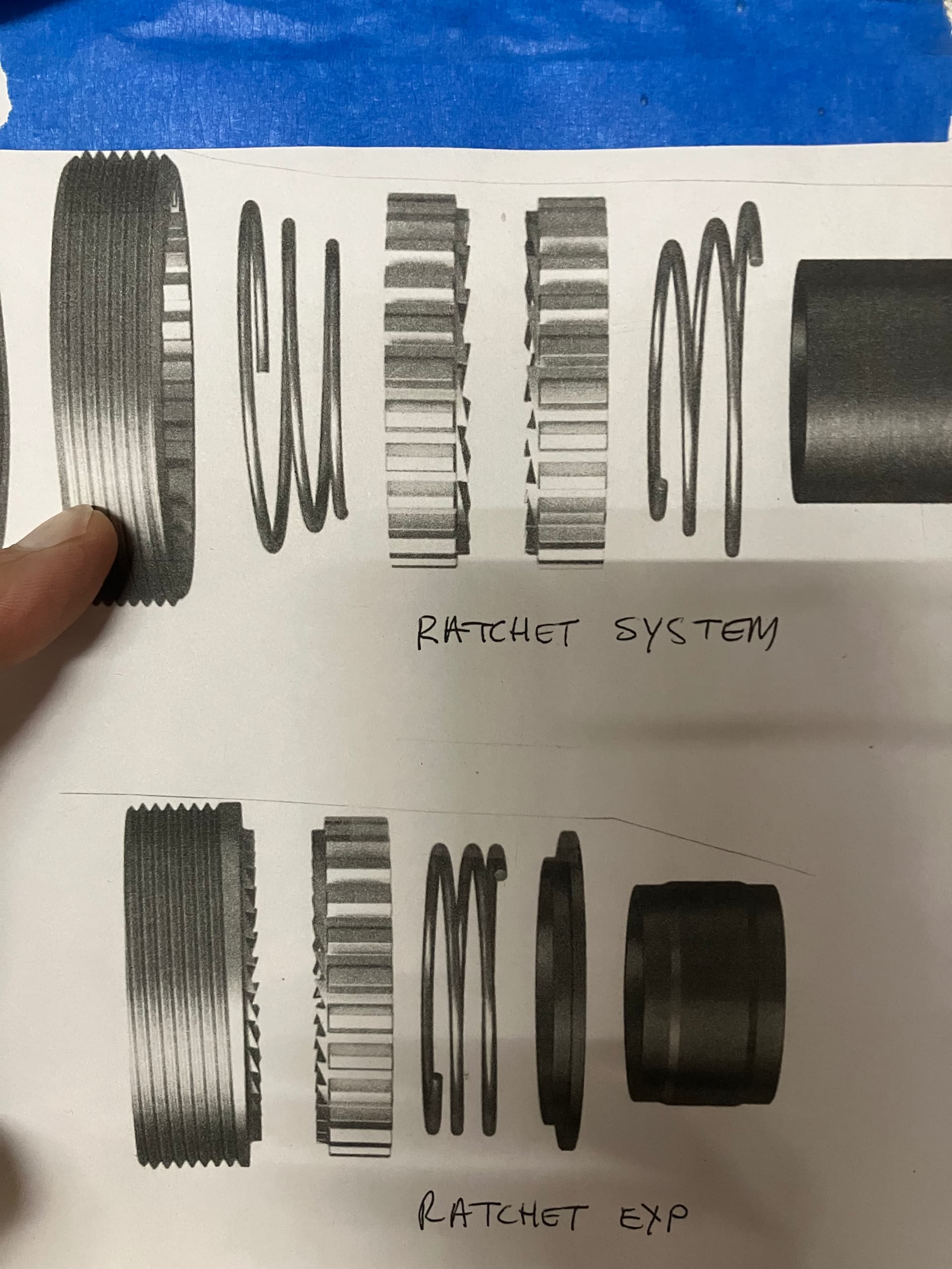

Is it a Ratchet EXP freehub? The first production batches of that freehub ended up with a known issue where the single moving ratchet would get stuck in the freehub losing engagement with the hub, typically on a descent. My 2022 Roval Control SL wheels with a Ratchet EXP freehub recently was warrantied by DT with a full star ratchet replacement and freehub replacement, no questions asked after providing the hub serial number.
From Ratchet Technologies Overview | DT Swiss | DT Swiss it seems that the EXP is not used in the 350.

FWIW, I had a non EXP DT 240 hub lose engagement. One of the aluminum rings that one of the ratchets slid in became damaged and the ratchets slid erratically. I replaced it with a steel part from a 350 hub and problem gone. DT replaced the part licketty split, with a steel part. All of which is to say, I guess that your clients 350 probably is not losing engagement. But, if you want, take off the cassette body and see if the ratchet slides smoothly, to further satisfy yourself and your diagnosis. Good luck!
@Babs if I may ask, any ideas how that aluminium ring got damaged? It seems curious to me, since it’s usually “sandwiched” between the hub axle and the ratchet ring, and should only slide along the axle, while in use.
In any case, just intrigued at the possible causes.
I think it was just under built/not the right auminum, or not treated/anodized correctly? My weight in the 200lbs range couldn’t have helped. : (
And - I’m talking about the ring that threads into the hub shell, annd stays put, and the star ratchet slides in the grooves in the ring. That thread in aluminum ring is what gave out on me. The grooves on its interior circumference were chewed up and the star ratchet would get hung up.

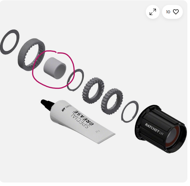

Ah, okay, got it, and thanks for highly detailed explanation! I had assumed it was that bit (thought it’s steel and not aluminium) in the photo instead. Glad you’ve got it sorted out :+1:, though I’m thinking that it must have been painful removing that ring if the teeth had been worn off :sweat_smile:
Teeth were still there ( just not lookin very good) fortunately. Those rings are tough to get out even under good circumstances. I had the right tool and treated myself a nice long breaker bar.
I only found out those rings are screwed into the hub when I stripped mine - so the ring turned in the hub. That wasn’t coming out. ;-(
