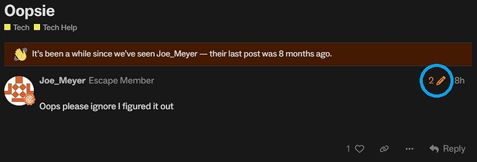

Oh come on! That’s mean! I want to know what we’re not talking about now! :rofl:
If you clicked on the highlighted pen icon at the top right hand corner of the message, you’d be able to view the history of edits made by the author.
I reverted it - the info might be useful for someone else sometime!
Fancy! I wish I could remember that for next time. :winking_face_with_tongue:
