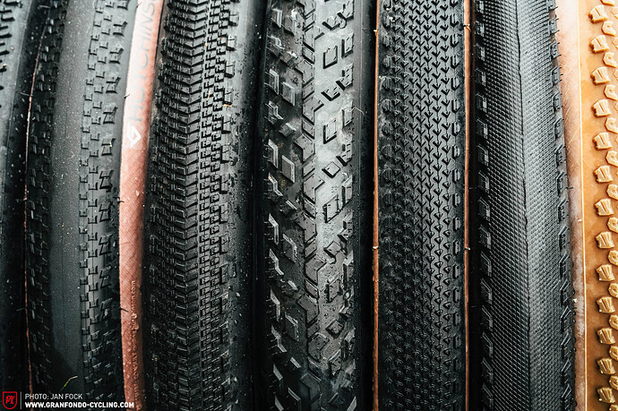

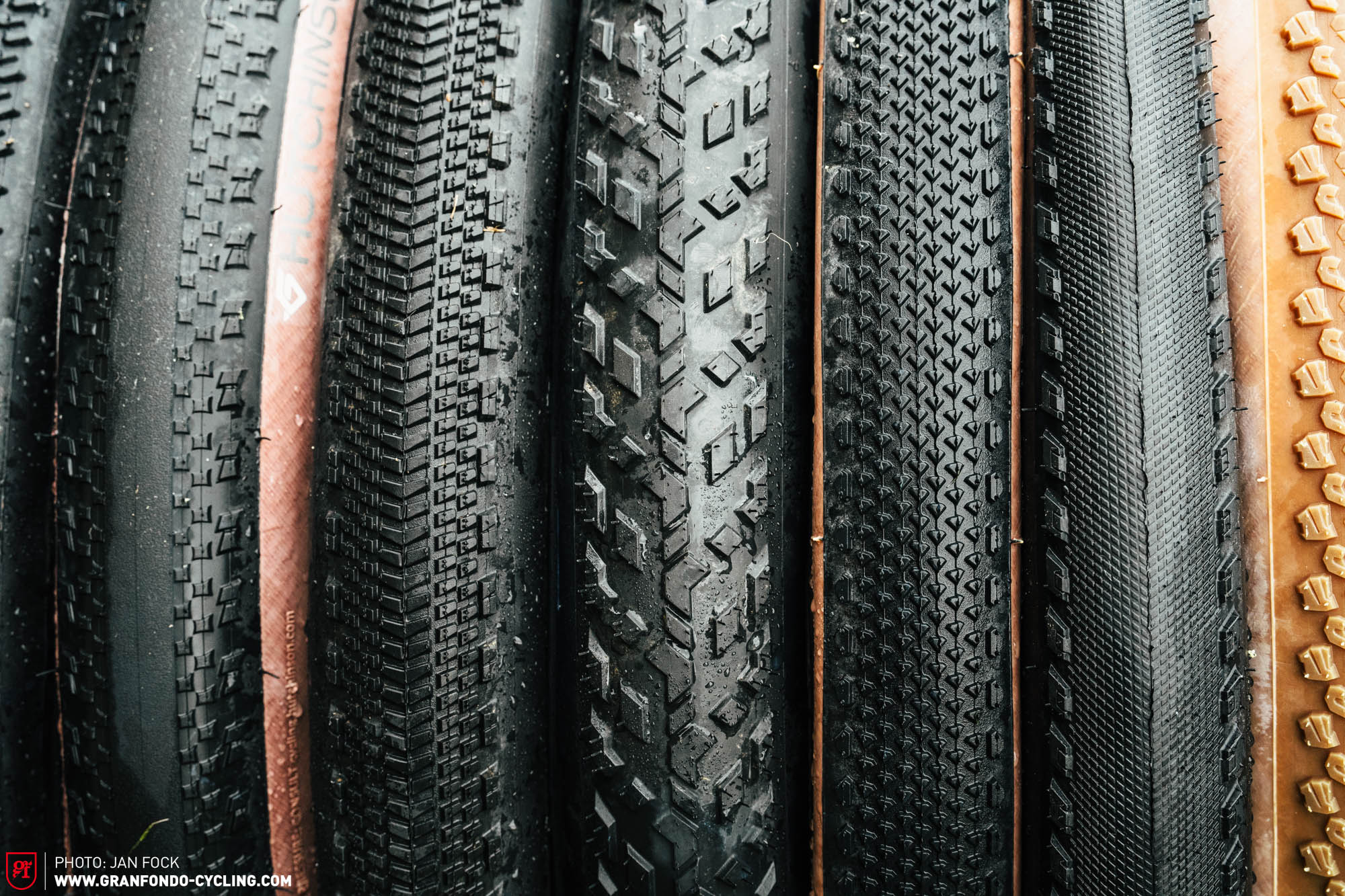

I was recently trying to decide which tires to get and found this gravel tire test to be really helpful:
