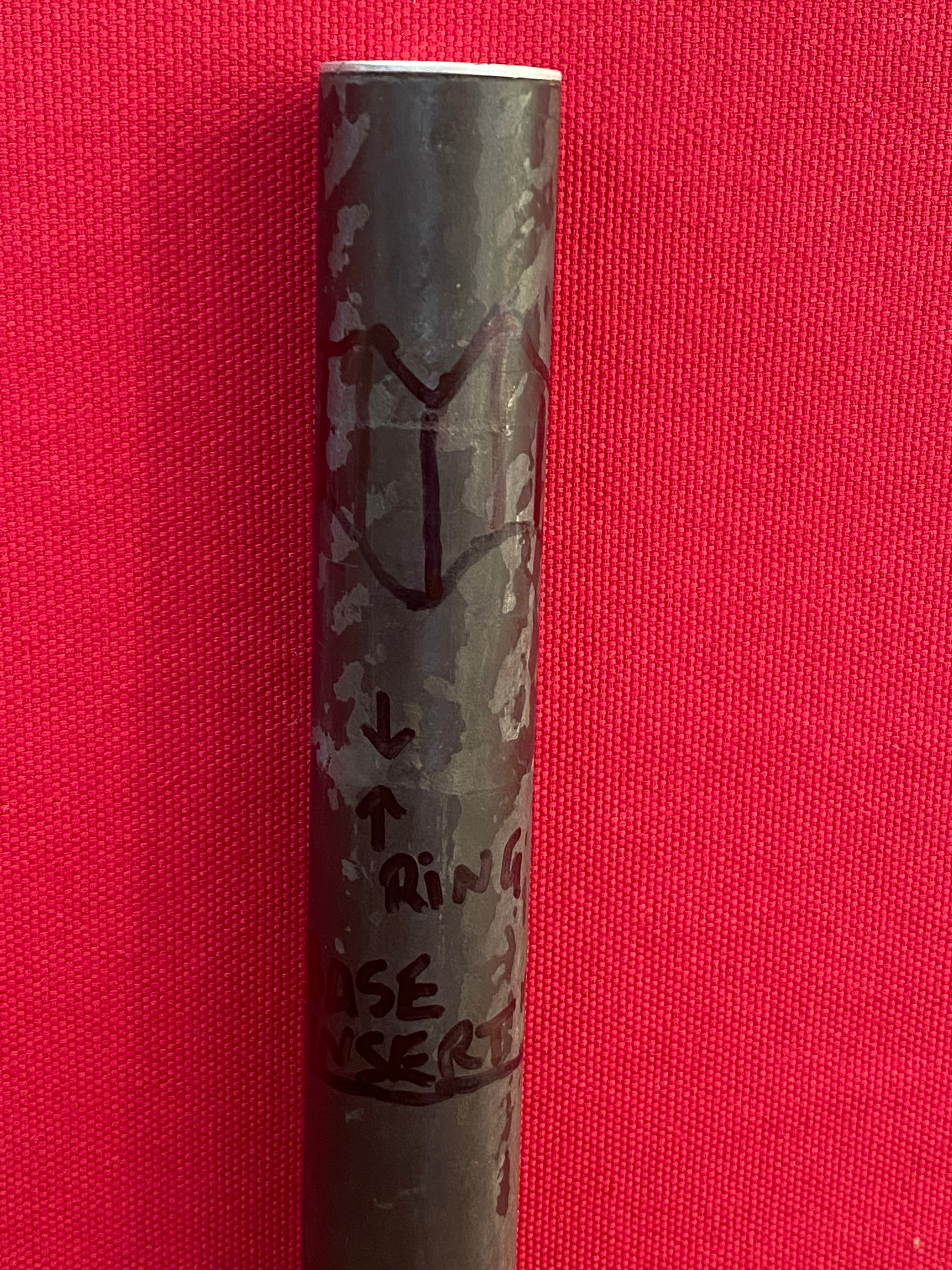

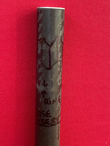

As a follow up, I recently checked the CAAD12 fork steerer with the bonded Zinn insert. By tapping, it appears to be no longer bonded around the full circumference, from 1cm above the base of the stem, to 2cm below - where the upper spacer is. The pattern is symmetrical. I suspect this is due to flex. I’m not too worried about this as it’s still supported internally but the slight ring barking from the lower bearing is a problem.
Super interesting – I was wondering about the differential flex of this system. I love that you’ve followed up with both an analysis and a, annotated picture, though I supposed I should’ve expected nothing less from this crew. Thanks Robert!
