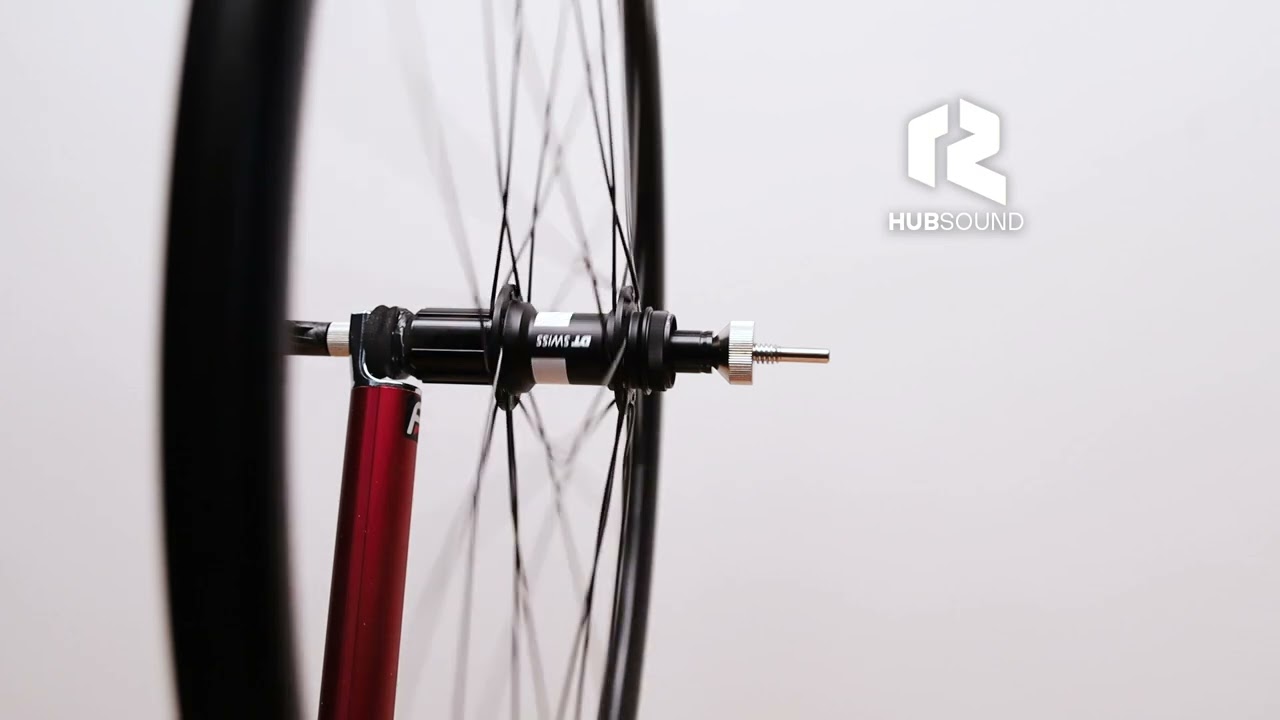

BTW, just found a cool playlist created by R2 Bike with different hub sounds (even though it is not always clear what system and number of poe they have.
Here you have 240 EXP sound:
And 240 EXP 36T followed by 54T (which is louder):
https://youtu.be/_Jre3ajefro?t=112
