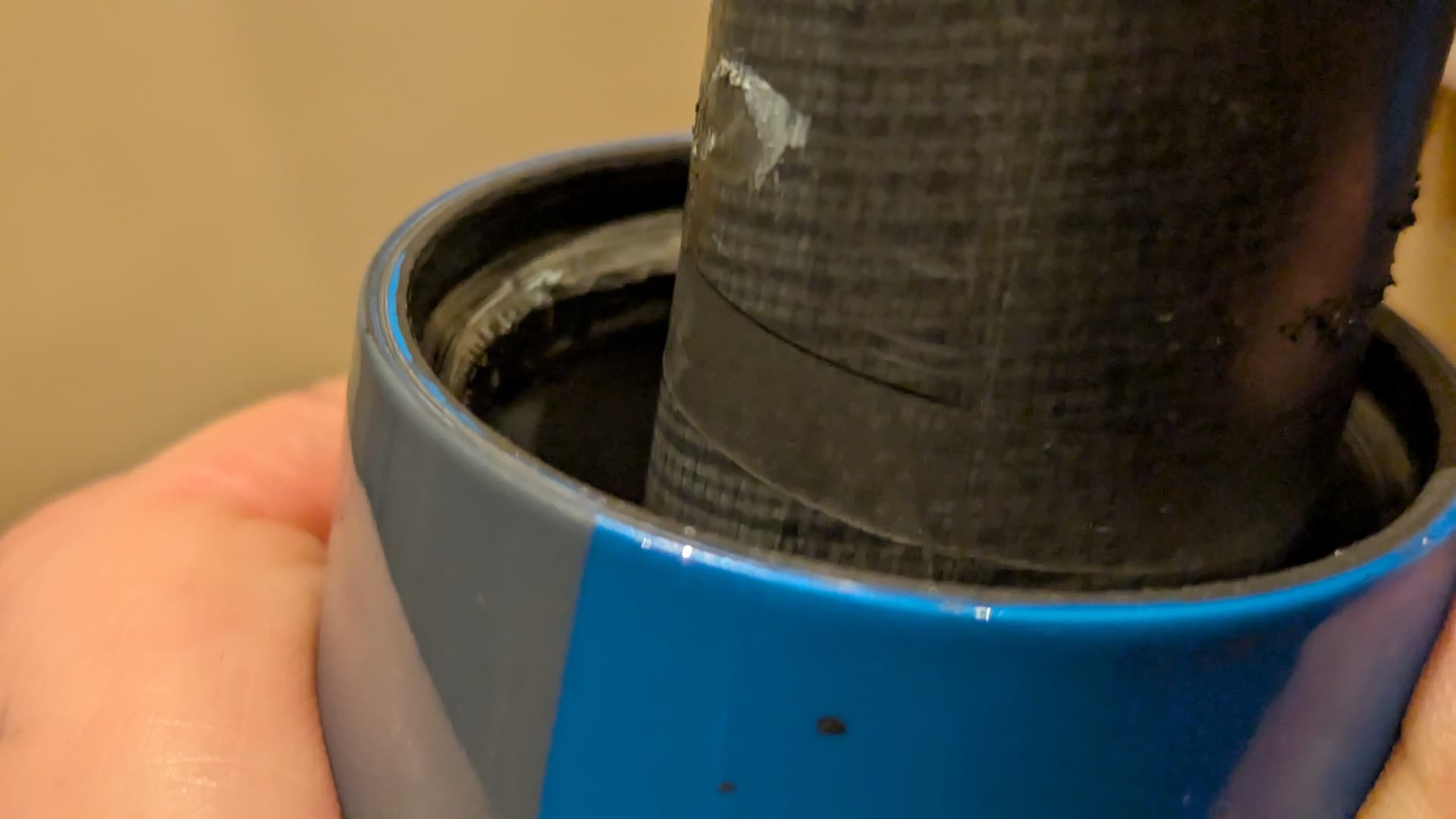

Is my carbon steerer ring of d00med?
My local bike shop commented that my road bike’s headset was loose when I visited. I tightened it up once home and then remembered something about “rings of doom" in this exact scenario. I see a ring formed around where the top headset bearing sits.

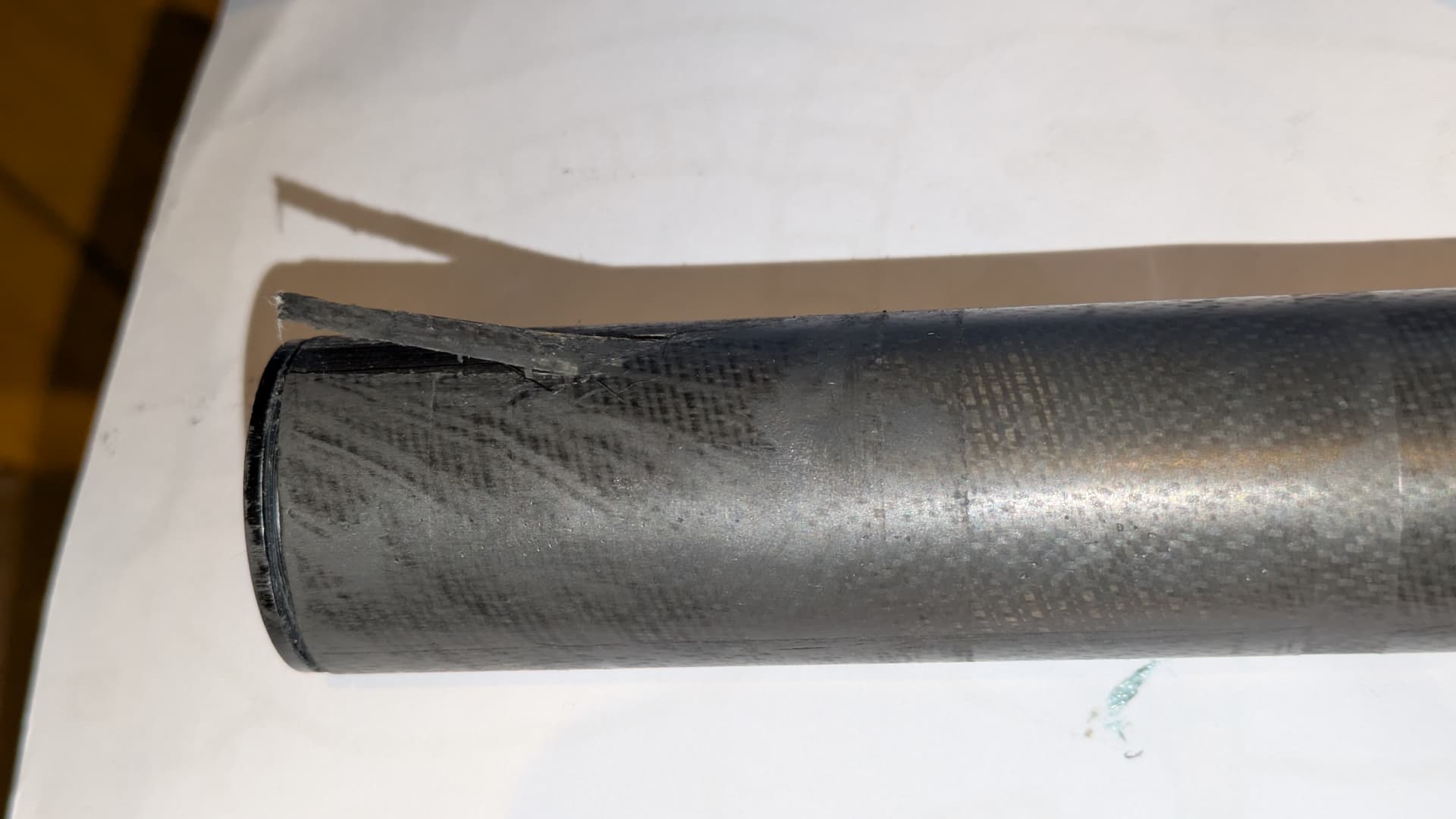

There is also some declamation for the outer layer from the top. Not sure if normal.

I wouldn’t ride that.
On a scale of 1 to 10 where 1= nah that’ll polish out and 10= why am I not dead? that’s a solid 7.5 maybe 8
Yup, decent RoD there. Delamination of the cut steerer too.
That’s replacement fork territory for sure.
To me that delaminated piece of the RoD means there could be delamination or some other damage elsewhere. That’s refuse now.

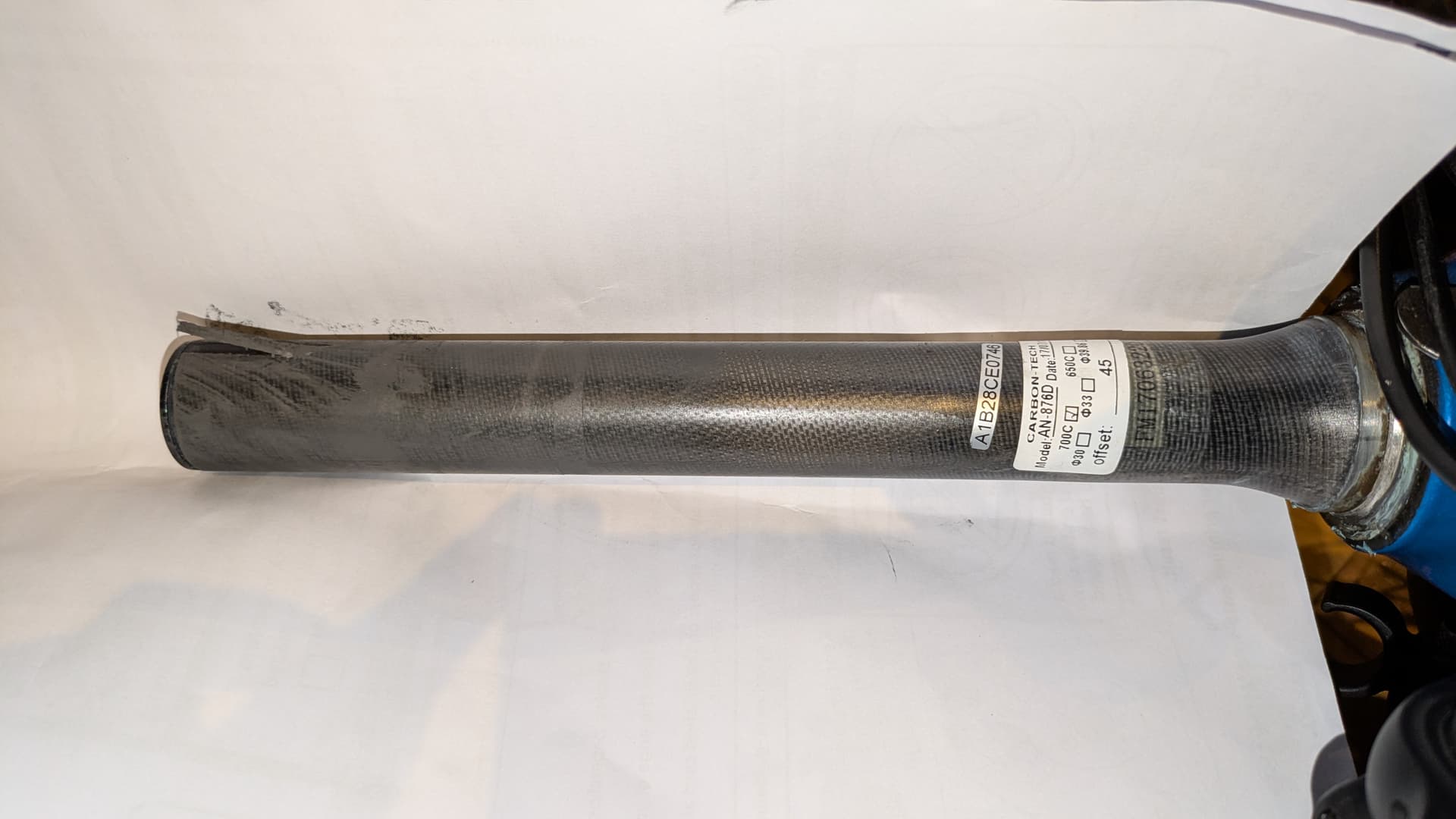

Less so (but not undermining the Ring Of Death), is that section of what looks like abraded carbon fibre just above the ring, on the left of the steerer tube. That looks worrisome.
I’m also curious how (if at all related), a loose headset bearing could cause the delamination at the top of the steerer tube. I’m with @RichGearing that that’s definitely a Stop Riding condition.
Thankyou all for confirming. Glad my LBS caught the loose headset. Time for some replacement forks.
Did the shop disassemble it to check? Or was it you after getting home and thinking about it? I think the PSA to anyone, especially a shop is to use any issue/work around a carbon headset as an opportunity to check the steerer and bearings.
That looks scary! Rings at both the top and bottom plus the delam peeling off, yikes!
