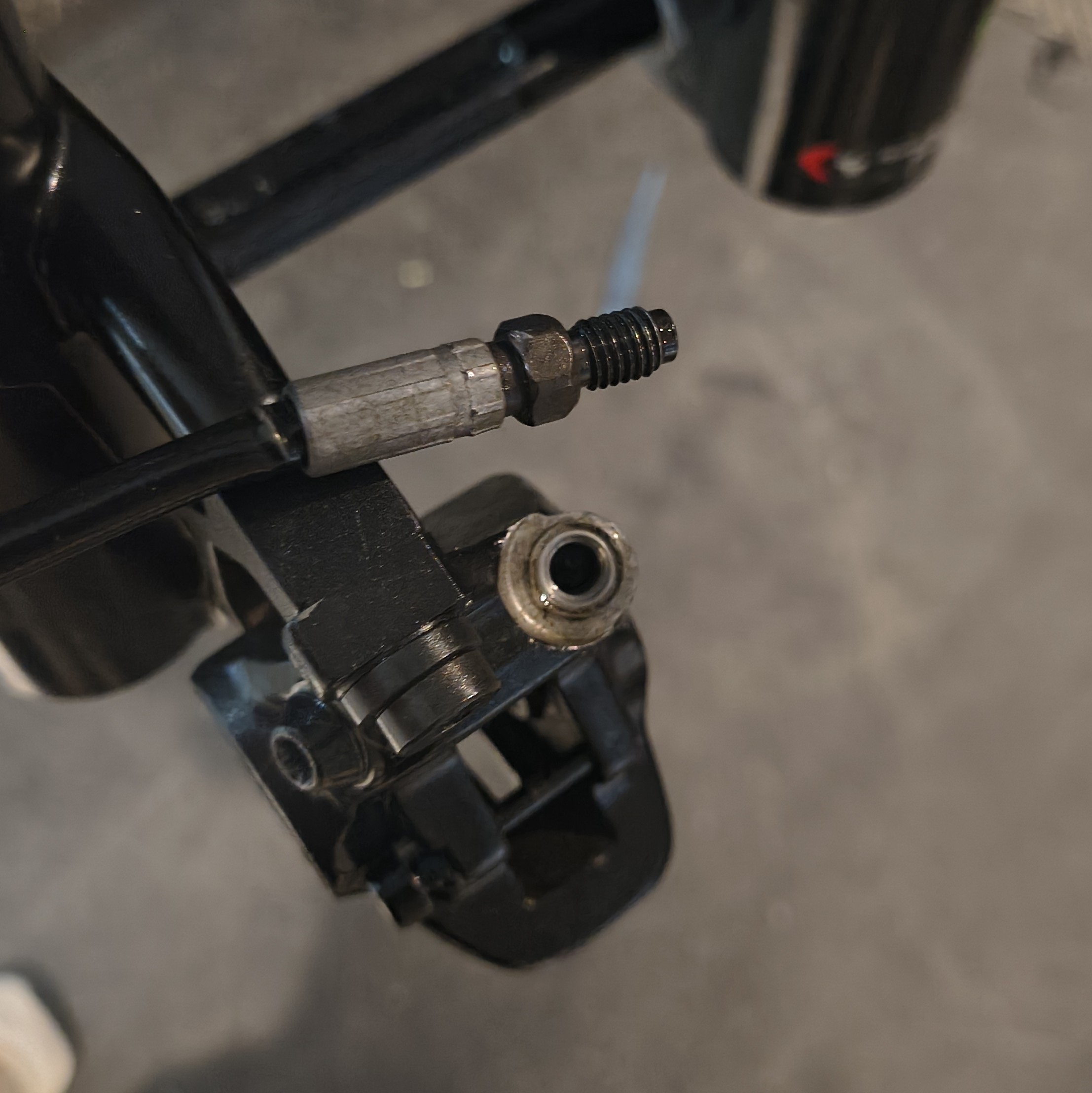

I have a 2015 Specialized Stumpjumper HT Comp that haven’t used in years and has spent the last few years getting used and abused by my son. Nearly everything needs replacing so I’m turning it into a monster cross gravel bike using what I have laying around. The whole project will cost me nothing :joy:.
I’ve run into a problem with the brakes. I’m keeping the original Magura MT2 brakes on it to be paired with Ultegra shifters. I have to replace the hose so I got Magura olives and barbs. Now I’ve taken off the hose and have no idea what’s going on here. There’s no olive or barb and this bit that ends with the nut doesn’t seem to come apart. What do I need?
That’s a factory-fitted hose fitting. I’d suggest looking at some aftermarket hose fitting options (Jagwire, for example) that will allow you to mount a hose into that caliper. Just be warned that not all hoses have equally internal and external diameters, so I’d suggest matching the fittings with the hose (such as, Jagwire to Jagwire).
Thanks. Nothing’s as easy as it should be.
