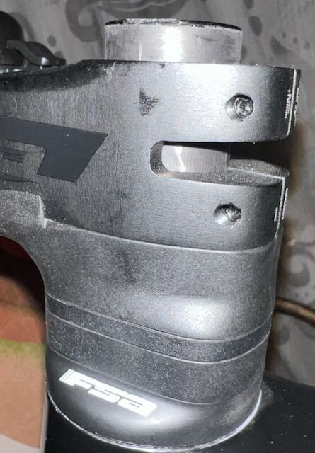

Yes! I forgot that one existed, that’s the FSA equivalent of the Superbox. I found this image that should help:
If I understand this one correctly it would also route the cables only under the stem, so I could in theory remove or even swap the stem without cutting hoses, right?
Because if that’s not possible I’d avoid this system.
Yes, you can route the hoses under the stem through the shroud so stem swaps are possible without cutting hoses. You would pretty much be restricted to the same model stem in a different length because of the shroud, though.

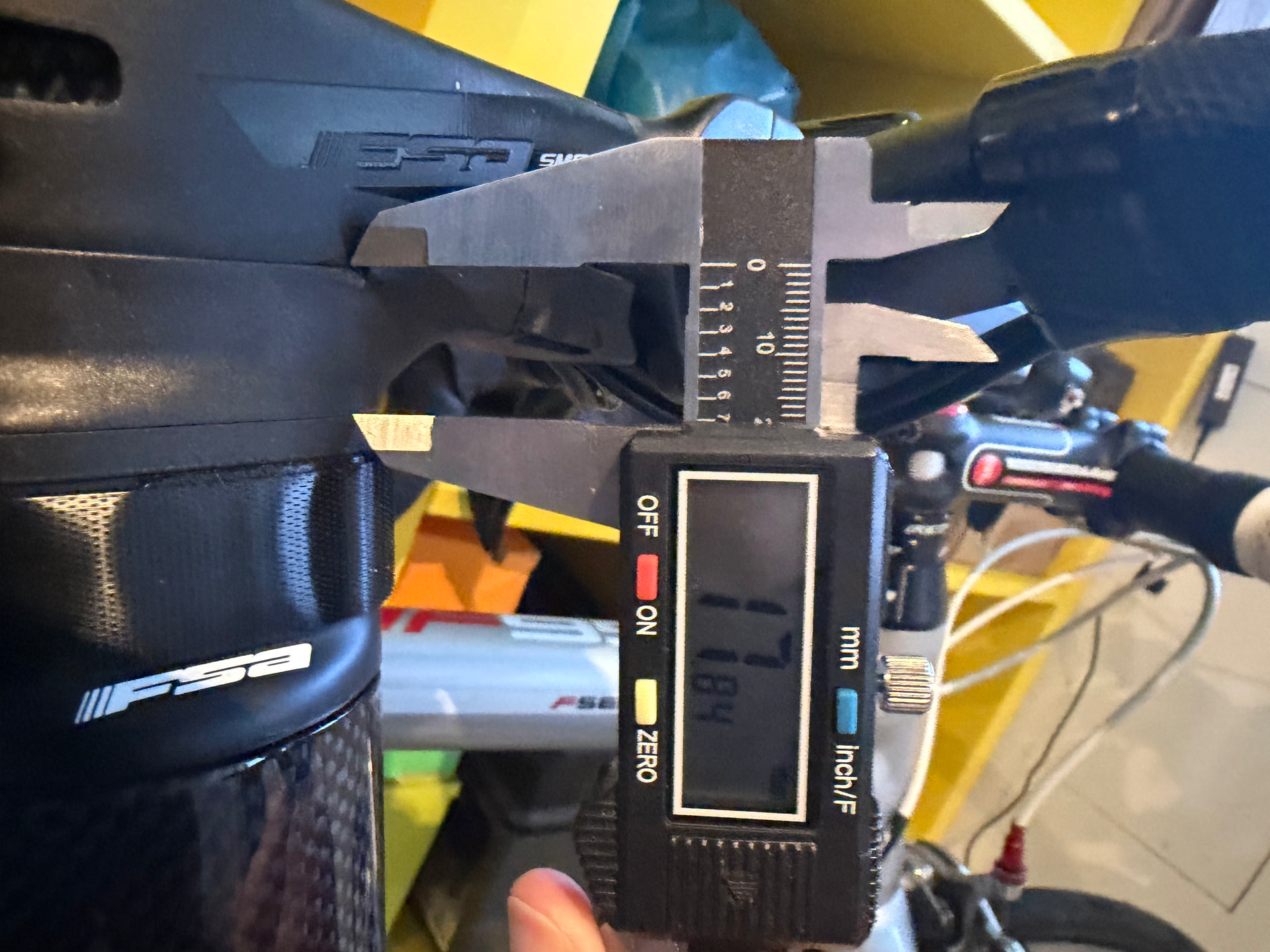

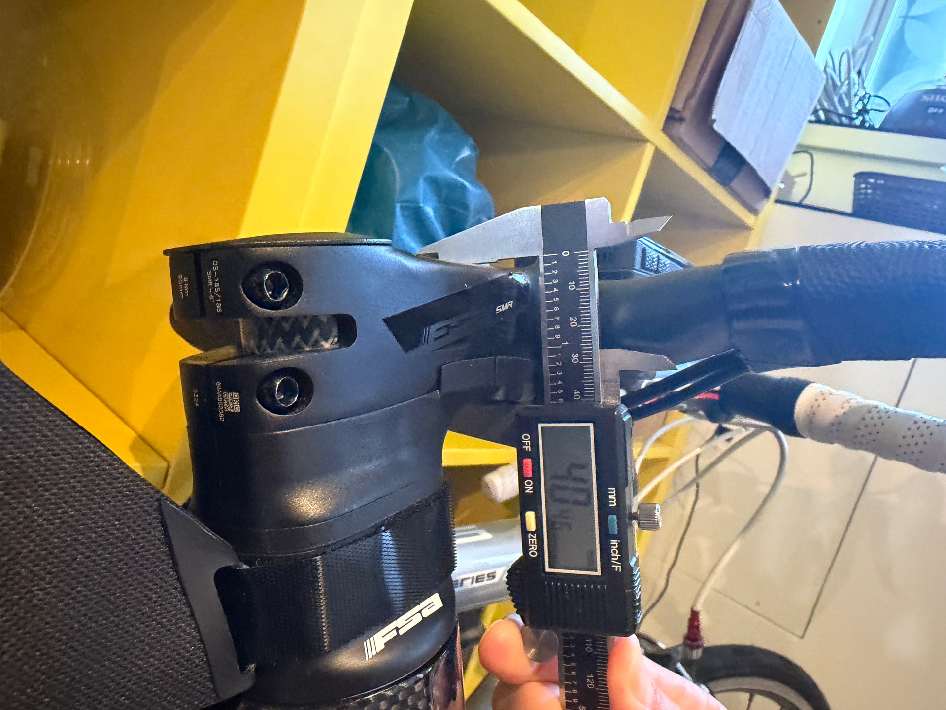

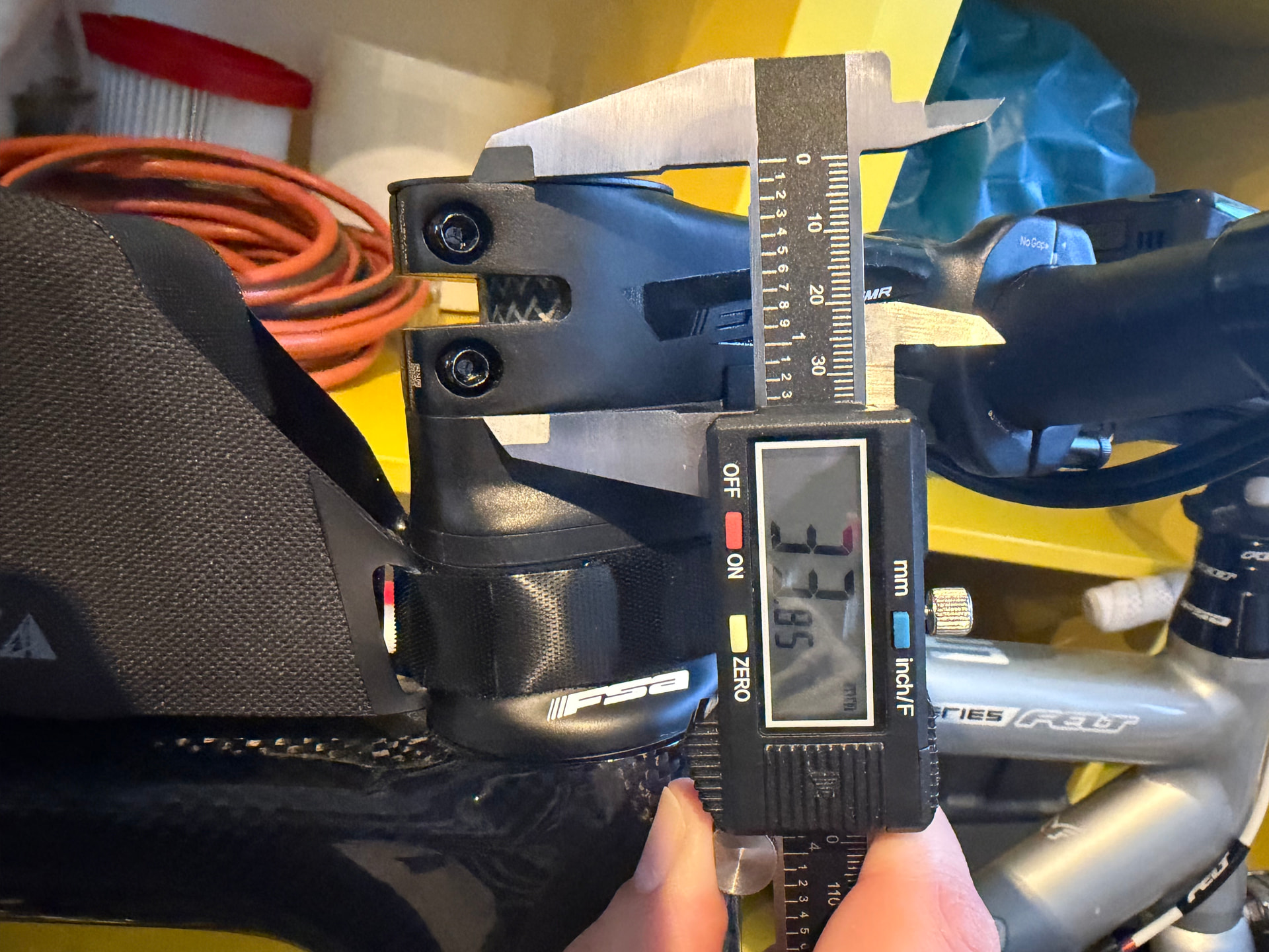

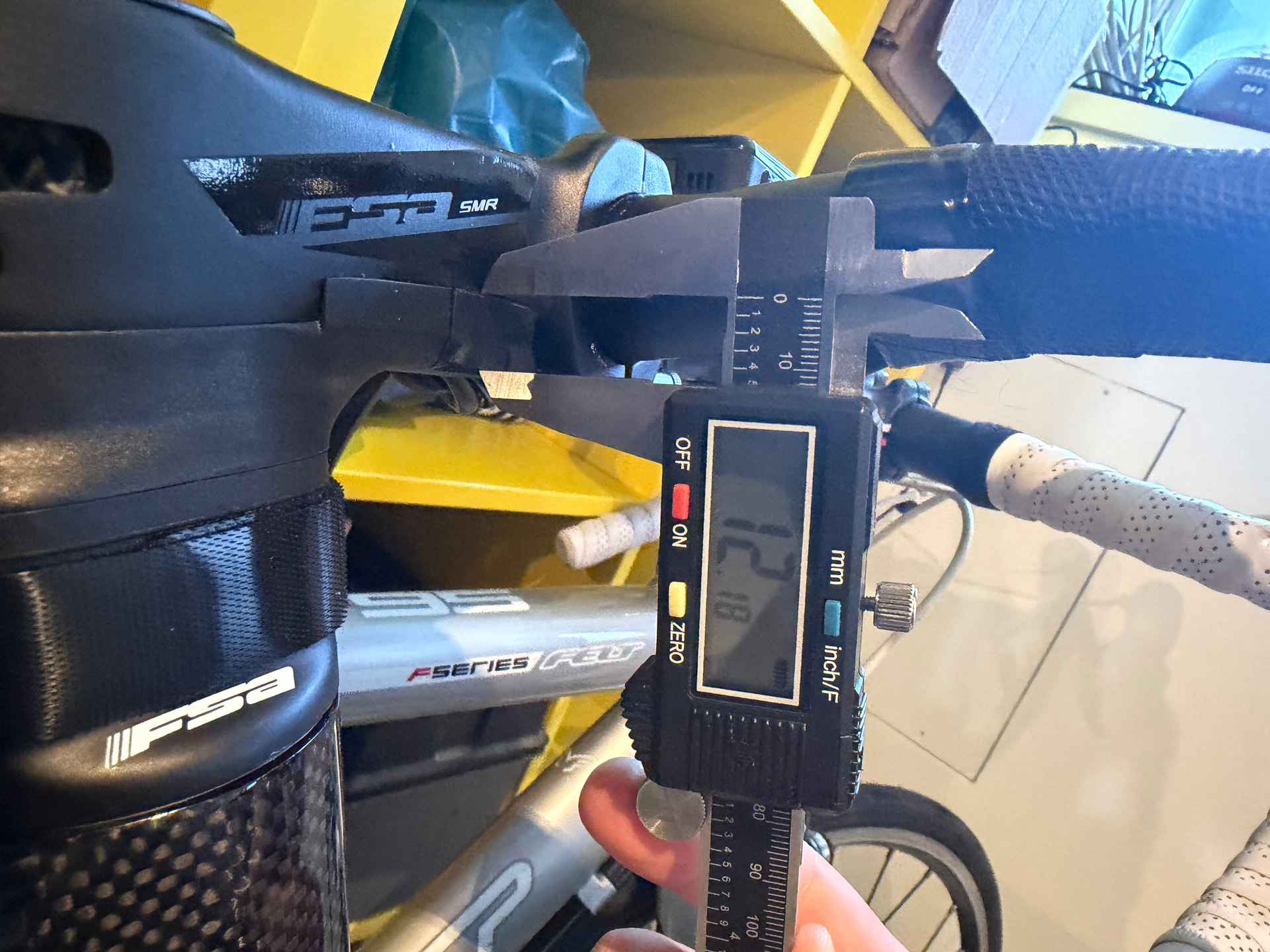

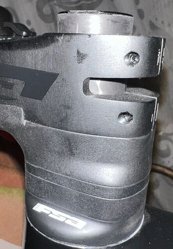

Drew, I am looking at this stem for a new bike build, can I ask you a favor? Would you be willing to measure the stack height of the stem clamp area, and then also the stack height of the cable shroud that goes underneath it? I haven’t been able to find this info anywhere. The FSA website gives a 33.5mm stack height, but I can’t believe that includes the shroud.
Thank you so much!

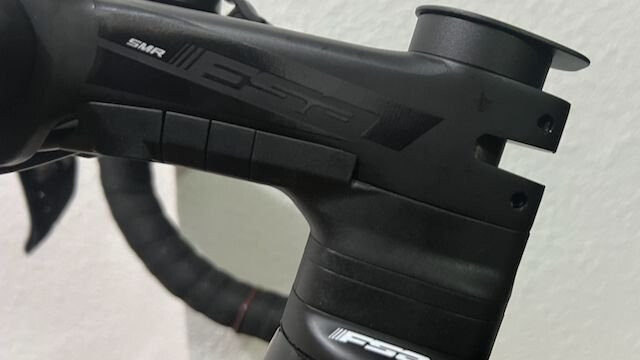

Sorry but I don’t actually own this stem, I was just pulling images I found online. I would believe FSA’s 33.5 mm number for the stem itself because the clamp does seem just a bit shorter than your standard 40 mm stem. As for the shroud, you may be able to scale it off of this other photo I found:
Here you go, hope it helps:
