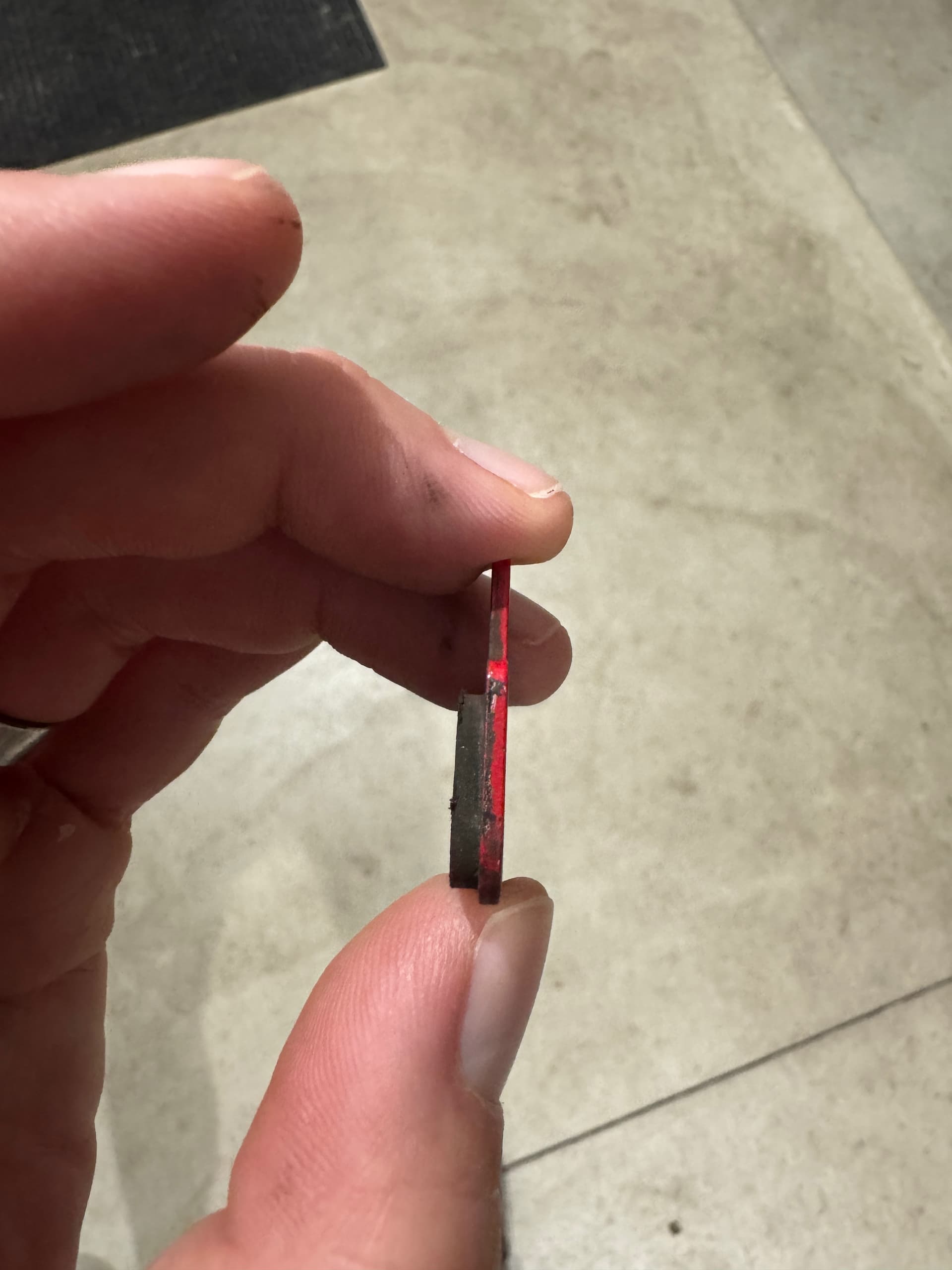

I use MTX Red pads … so no, no cooling fins. However, they are MTX’s RL160’s and not their RL165’s … so they’re slightly different shape than stock SRAM pads. MTX claims they work the same, but maybe something about the shape difference allows them to rattle after reaching a certain amount of wear? The sound did seem to start during that race after a quite long (12ish miles?) descent with a lot of hard braking. I’ve looked at the pads and they don’t look very worn … but maybe that’s it?
I’ve still got the stock SRAM pads somewhere, so maybe next step is to swap those back in and see what happens.

Well, I’ll be damned. Seems like swapping the front brake pads to the stock SRAM pads solved it!
I find it odd though. I’ve been running those MTX pads basically right from the start of ownership, and they caused no issues for over 1000mi. And they definitely don’t look significantly worn … so why it would rattle now is a mystery :person_shrugging:
