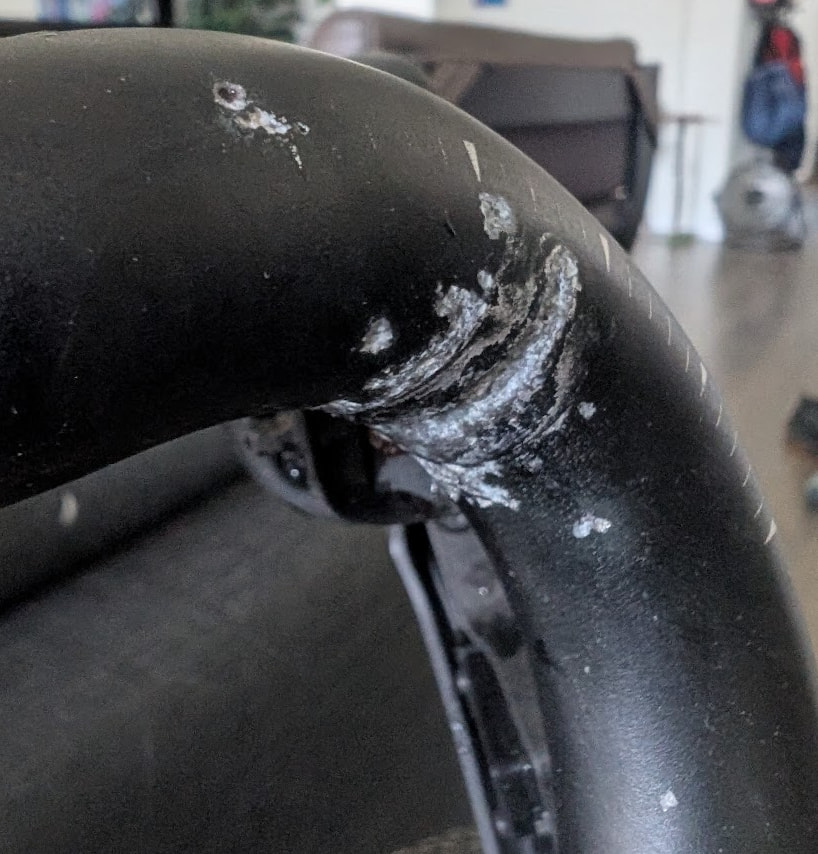

I’ve been running aluminum bars, tried a few brands and a few different finishes, I’m nuking them all within about 6 weeks during the summer:

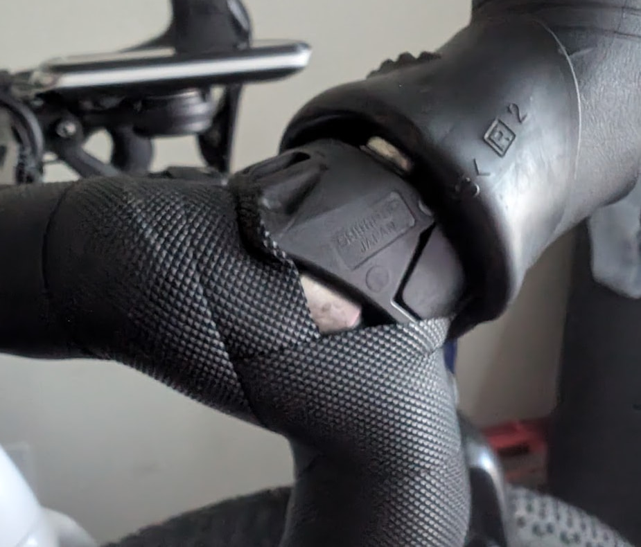

It’s starting to get expensive. This is all outdoor riding, usually long intervals make lots of sweat, although I’m “flushing the bars after each ride. I changed my bar wrapping style to figure-8 so I could leave little exposed holes to flush with water after each ride:
When I install the bars I’ve been taking extra care to not break or scratch the anodizing, I’ve tried coating the surface in Boeshield, and again I’m still blasting the bars with water each time I do a sweaty ride. I’ve thought of blasting the area after each ride with compressed alcohol; spraying other chemicals in there seems bad. I tried some helicopter tape under the shifter and the shifters wiggled/moved when off-road.

Would wrapping the bars with electrical tape before bar tape help?
I tried this with helicopter tape and I can’t seem to get the shifters tight enough to not either break-through the tape or tear the tape when the shifters move in off-road riding.

Why not add the electrical tape after clamping the shifters? It won’t seal the bars entirely, but may do decent job.
Is the type/brand of bar tape part of the problem?

Might be worth trying a tape that is more breathable and won’t trap moisture as much. Perhaps the lingering wetness is contributing to the problem.

Is there a chance it could be your cleaning products, rather than sweat? Thanks to a dodgy cirulatory system, I’m a seriously heavy sweater (to the point it sometimes ruins my life) and I have yet to destroy any aluminium components. Unless you have some kind of severe hormomal imbalance or endocrine system issue causing you to sweat out important things, or stomach acid? I’ve seen a lot of destroyed trainer bike handlebars come through the workshop, but only ever after years of use, not weeks…

Maybe try storing your bike in conditioned space? If I understand correctly, “pitting corrosion” of aluminum - which seems to be what you’re experiencing - is a function of salt and humidity. You’ve tried reducing the salt by rinsing. Maybe try reducing the humidity via air conditioning or a dehumidifier?

Also consider the way you’re installing components and the torques you’re using. Your first image makes me question this - on all of the corroded bars I’ve seen, the corrosion has been on the top side of the bar, not on the underside / back of the bar where the lever clamp bites.
Aligning with this, it occurred to me that the flushing with water may be helping, but might also be part of the problem.
If the area isn’t drying out under the tape the corrosion might not be entirely salt related, and simply a galvanic corrosion due to two different metals being in contact, which is not good when wet, and worsened, rather than caused by salt.
Galvanic corrosion absolutely affects carbon too. Carbon frames are most likely to fail where the carbon is in contact with metal (headset bearings, BB inserts, dropouts, etc), because the galvanic corrosion can degrade the resin. The damage to bars as shown by OP might be different with carbon, and may or may not take longer. It may not be as obvious though, as it may take less visible damage for the carbon integrity to be affected to a dangerous extent.
