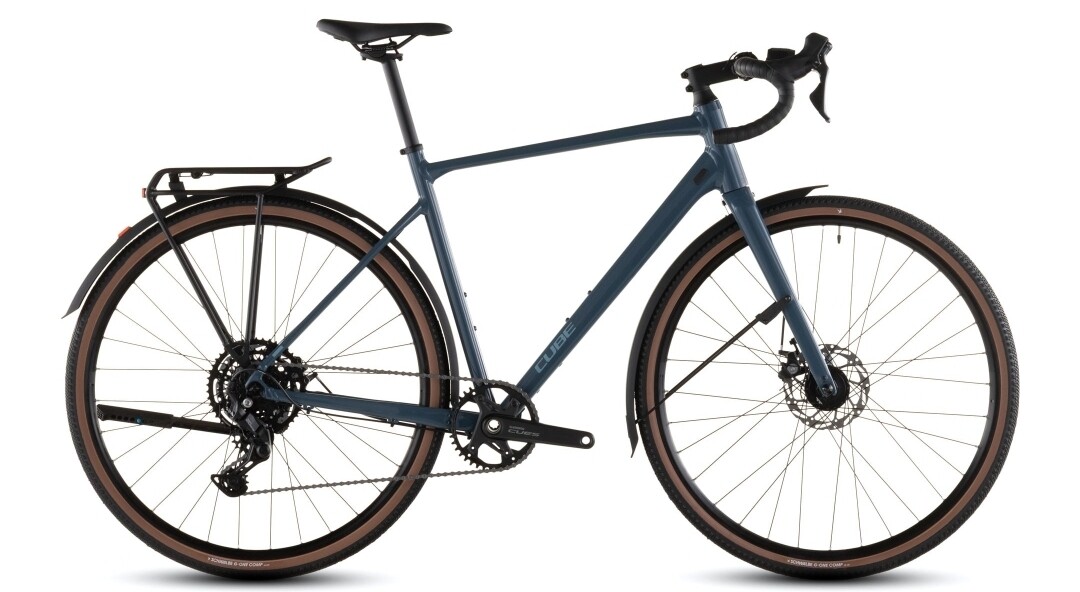

I’d go for something like this. Race-y commuter. Don’t worry about the brand, it’s more the type of bike I’m trying to show. “Gravel geometry” so it’s not too much of a jump from MTB to power commuter. Let the bike shop help you to get the right size and a decent initial fit.
This specific brand/model costs around 1000 EUR and comes with Shimano CUES gearing, which is very decent and plenty enough for commutes - while still good enough to discover other types of riding.
Don’t let the bike shop make you spend more because of fancier gearing (“groupset”) - especially if it’ll be standing outside 9 hours per day. The one thing you could/should spend more on, is hydraulic braking (the 1000 EUR bike comes with cable-actuated disc brakes, which is… meh).

Thanks for the help everyone. Very helpful. I really like the look of the bike Laurens posted. I’ll bump this thread whenever I eventually make a decision.
