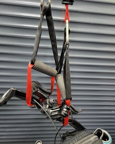

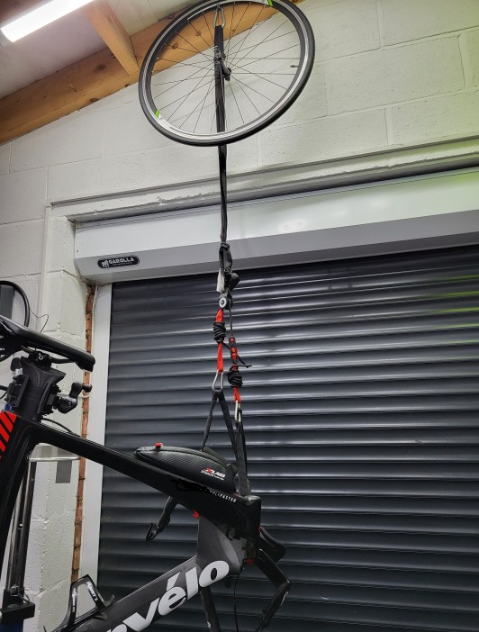

I have some suspension training straps that I use for this purpose. For me they work well when needed and are easily hooked away when not.
