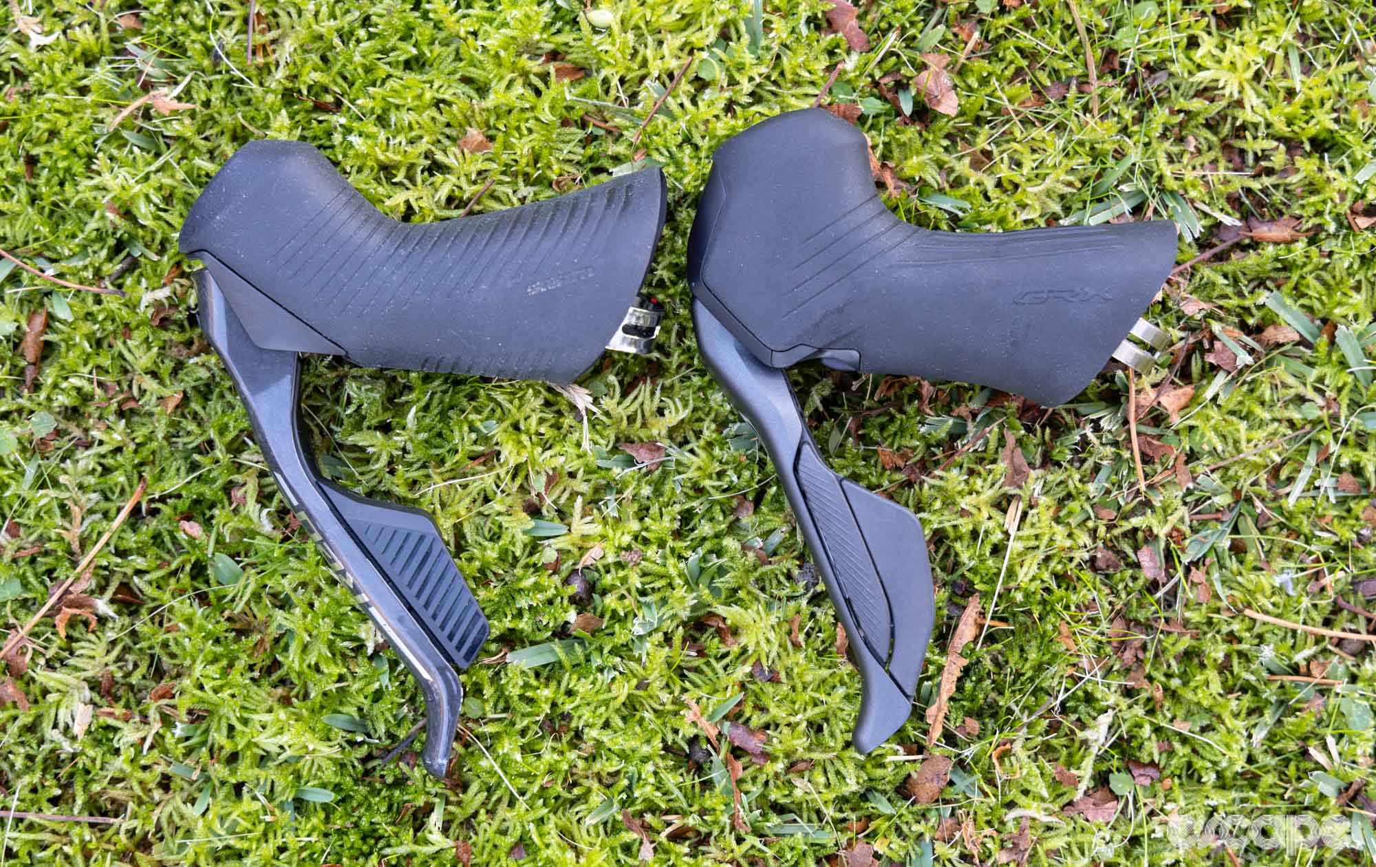

I’m currently working on something that should answer this in detail and more.
Here’s a photo in the meantime:
Yes!!! Both Sram and GRX seem like they share the same idea (I’ll not judge who was the first, Sram :slight_smile: ), the rubber seems more comfy on the Sram.

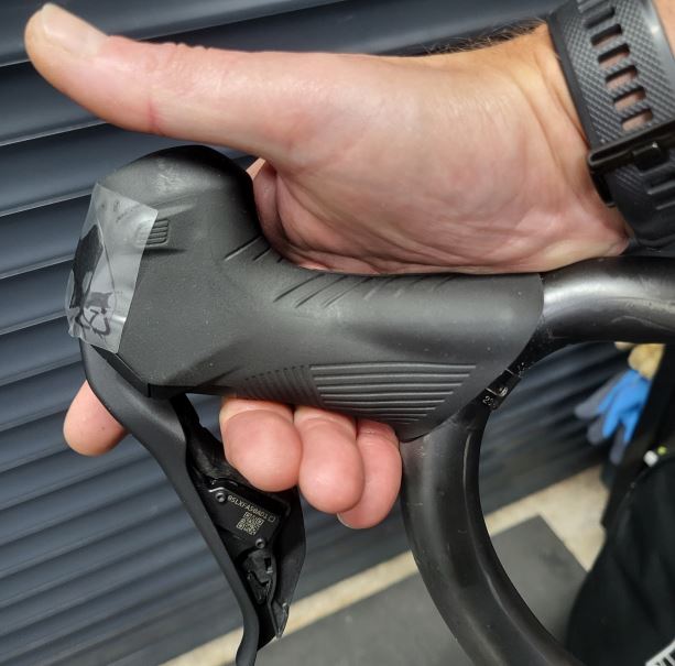

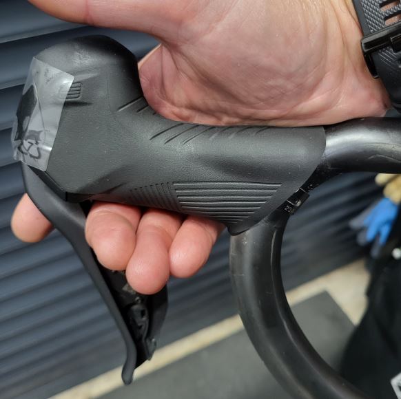

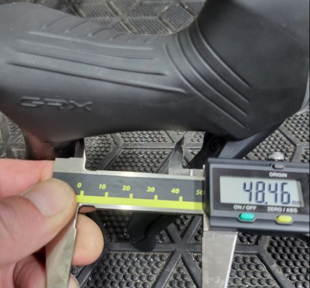

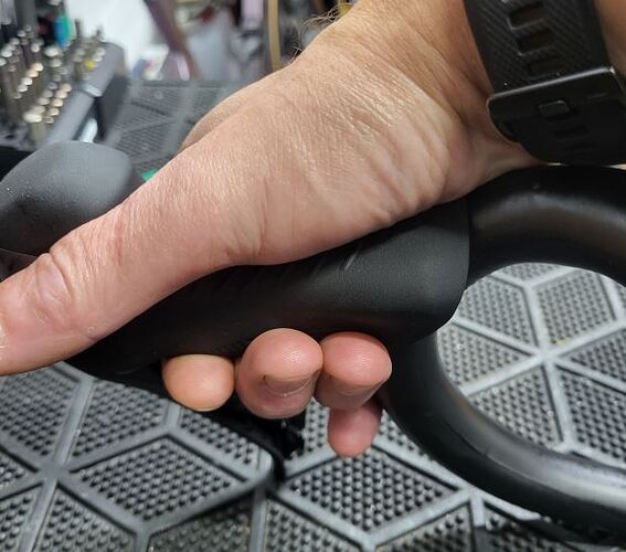

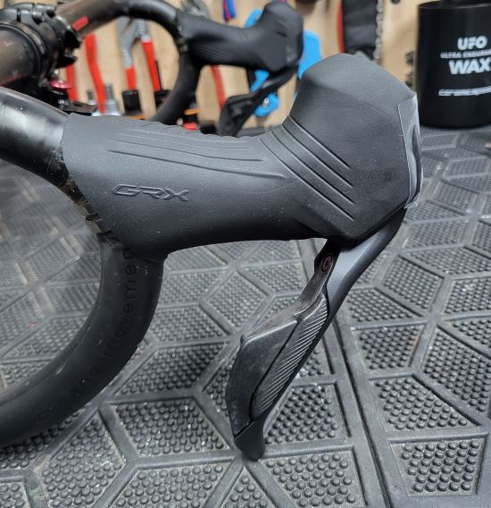

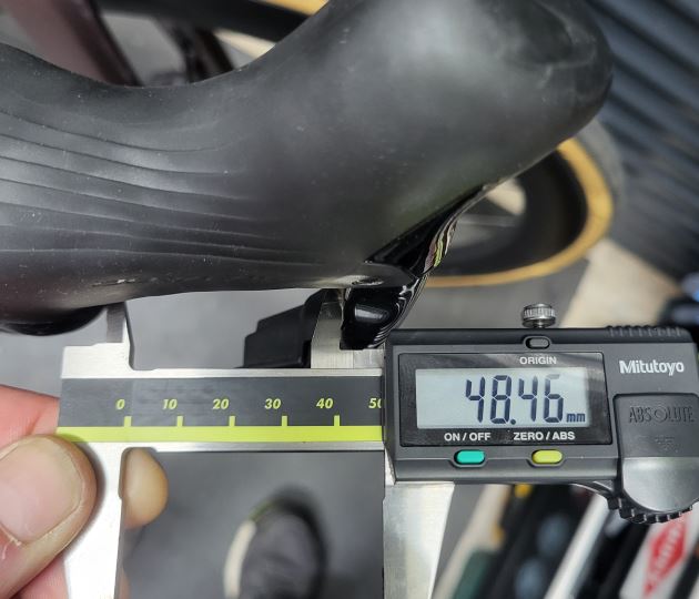

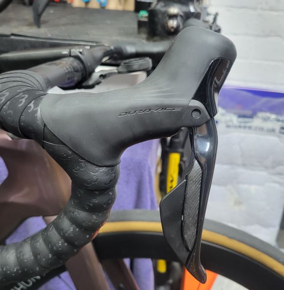

@Martin_Hnik Martin_Hnik later today I will have in my workshop a bike fitted with 12sp Ultegra (disc) levers and a 2x12sp GRX Di2 groupset for a bike build.
If you’d like me to take any comparison photos or measurements, please just ask.

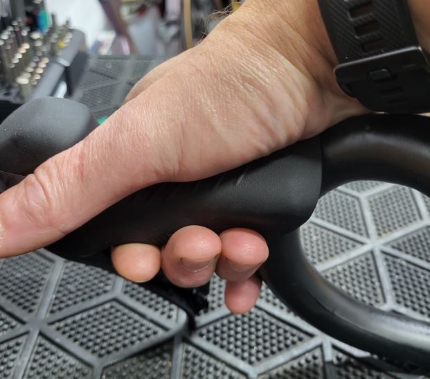

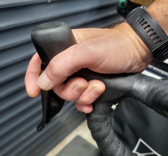

Hi Alex! Wow, that would be awesome. The most helpful photo would be with fingers wrapped around the hoods. Really appreciate it!
No problem, will take some photos later for you :+1:

Apologies, it is 12sp Dura-Ace levers not Ultegra but they are like for like.
First impressions, the GRX 12sp Di2 levers have significantly more room underside of the hoods. J can easily fit index, middle and ring fingers under the hood (note bar tape not fitted but I dont think that will make significantly difference). I can just about squeeze these fingers under the DA lever but it is not comfortable, the fingers are squashed/overlapping and I’d never chose to ride with my hands in that position.
Hope the photos help, let me know if you need anymore.
