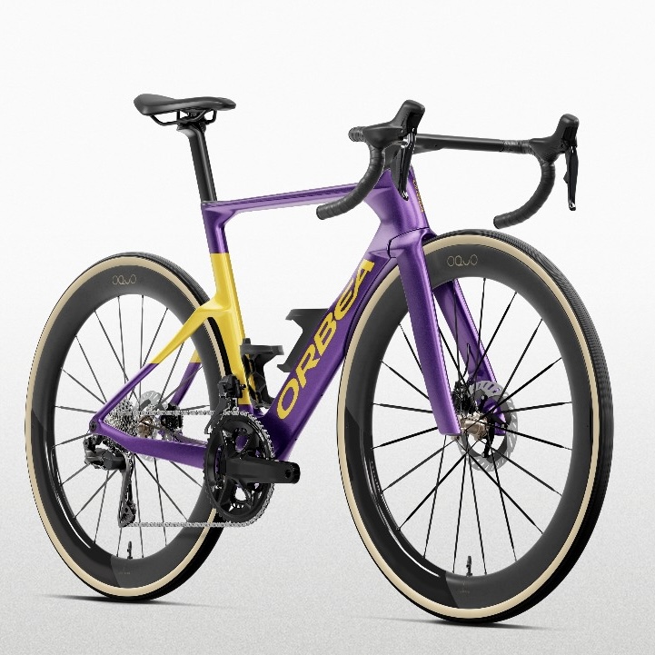

I’m glad you like the color. The free custom paint on Orbea bikes is a blessing and a curse. The blessing: You get to choose a bike with your personal BEST COLOR. The curse: Between this bike and my incoming Orca Aero, I have spent so many hours agonizing over what that best color actually is…and it seems to change from day to day, or hour to hour, sometimes. But for the Orca, I finally settled on a Wario-inspired color scheme. Good luck with your bike search!

Love it - and I TOTALLY see how picking the colour would be a nightmare of a dream choice. Awesome picks on both. Well played.
