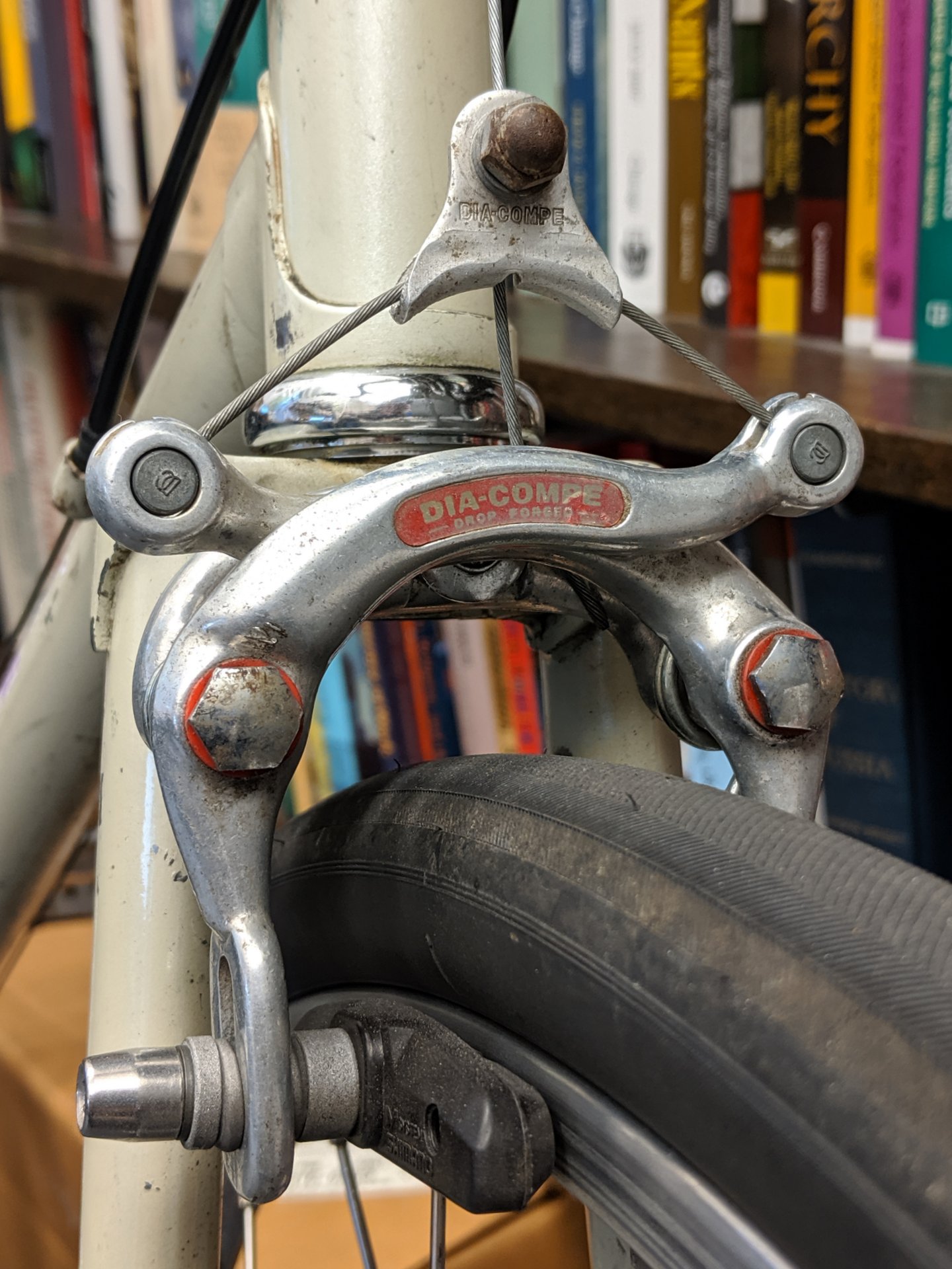

Here are the Dia-Compe brakes (from a 1981 Nishiki, albeit with new pads / cable housing / rims) that truly scared me on some descents. I’m 210 lb but have huge hands and never worry for braking power unless there’s a lot of flex in the system, and these brakes must have just “folded” - had way too much flex.

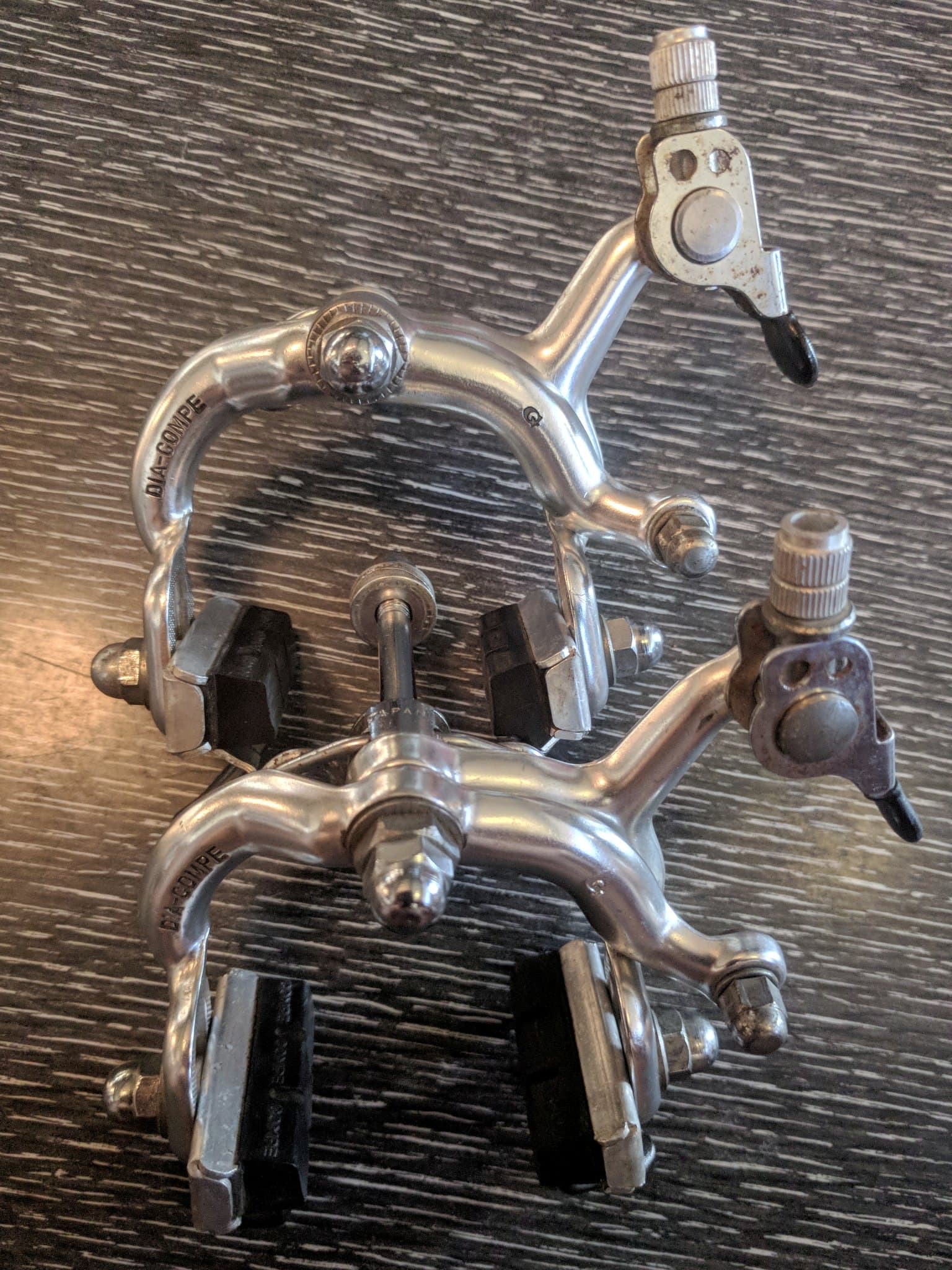

The funny thing is, my counterexample to these is a Gran Compe brakeset (1978, I think, a bit older than yours) that looks similarly skinny but wasn’t a problem (again, for my big hands). These absolutely didn’t fold and I’ve ridden them on real-descending courses. This is why I think it might be worth trying another single-pivot brake (just plug and play the front brake, no need to change anything else as long as pads & housing are good) to see if that provides sufficiently comfortable braking.
