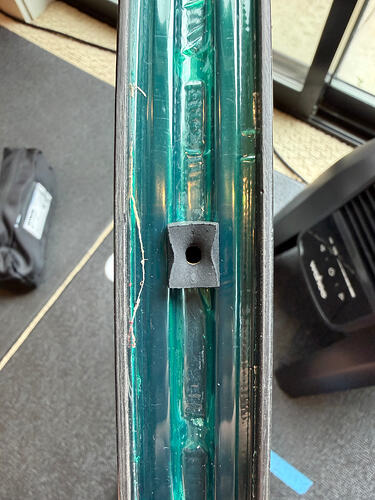

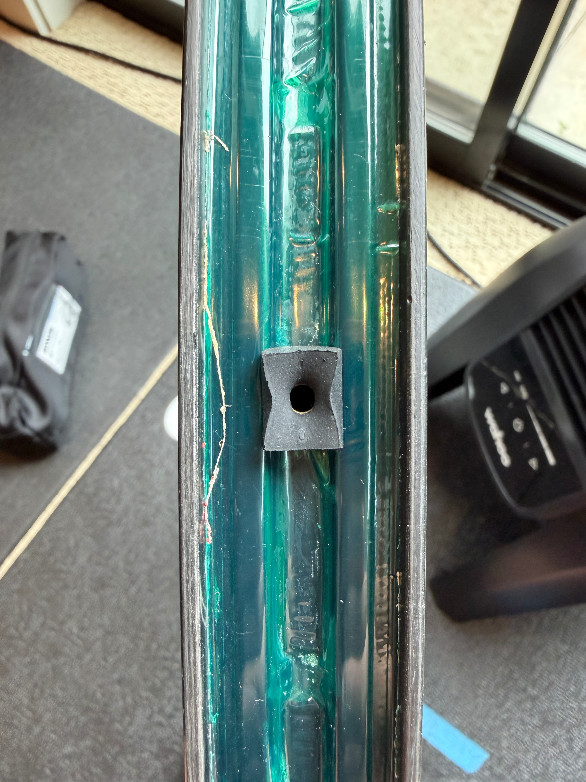

Top view:
Thank you, this is helpful!
Also, my photo was taken before tightening the valve stem, just to show the differences in shape.

Whether the sealant is coming from the valve base or at the nipples, the leak can be from the tape or valve. Once the sealant makes its way into the rim cavity, it can exit from anywhere.
An easy way to get the valve tighter is to find a rounded corner of a counter or table. Put the base on the valve against it and lean into the other side of the wheel. This will press it into the cavity, and you can then screw the nut onto the other side
