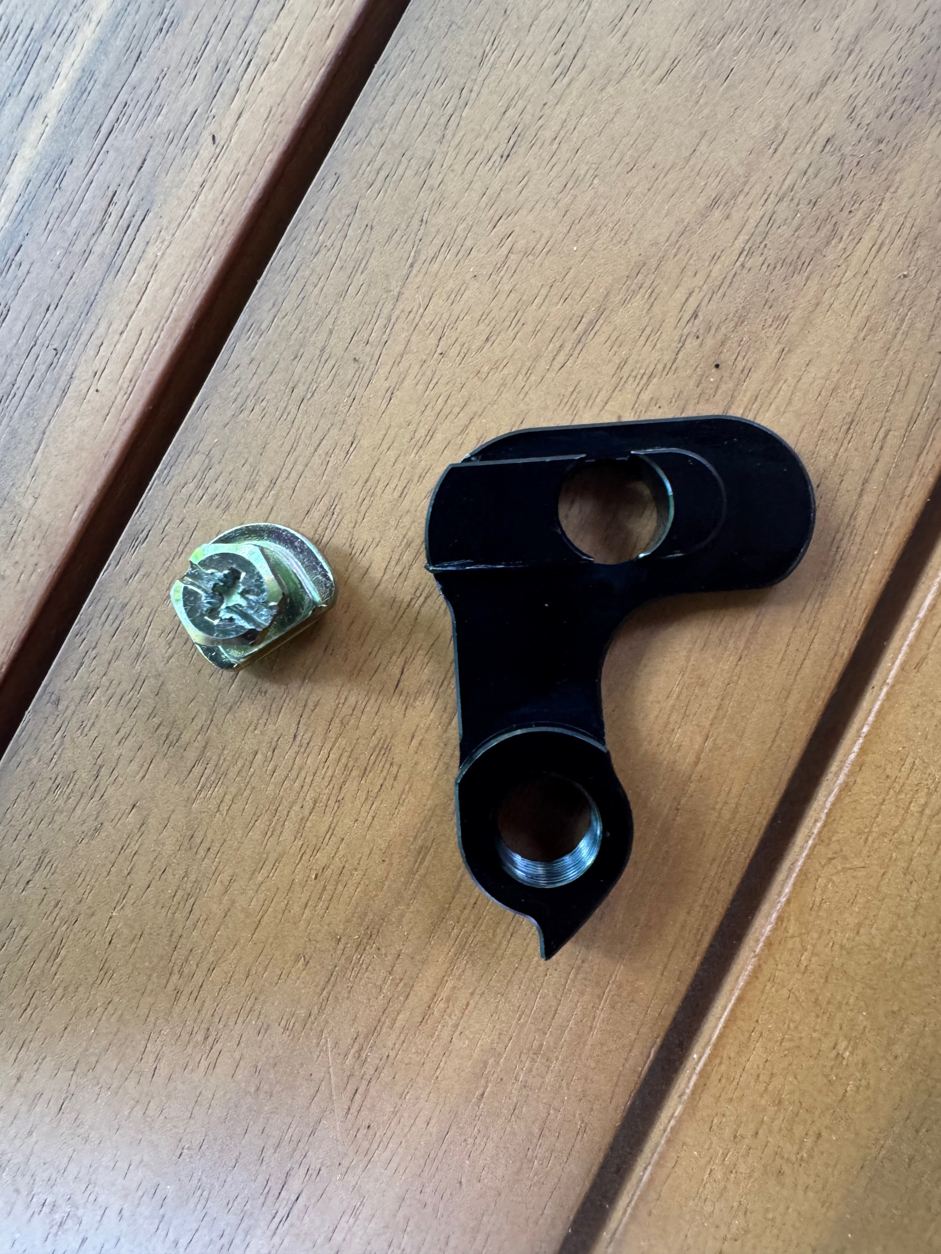

So I decided to make the best of it, and try to get some better parts on from my parts bin + a few that I bought. The part I can’t fix is the lack of derailleur hanger. I tried one of these tail hooks that adds one, but now the quick release won’t close.
The part to the right on the picture shows the part that I bought, the part to the left the screw that came with the derailleur it had (a very cheap 6 speed that bolts on, rather than use a hanger).

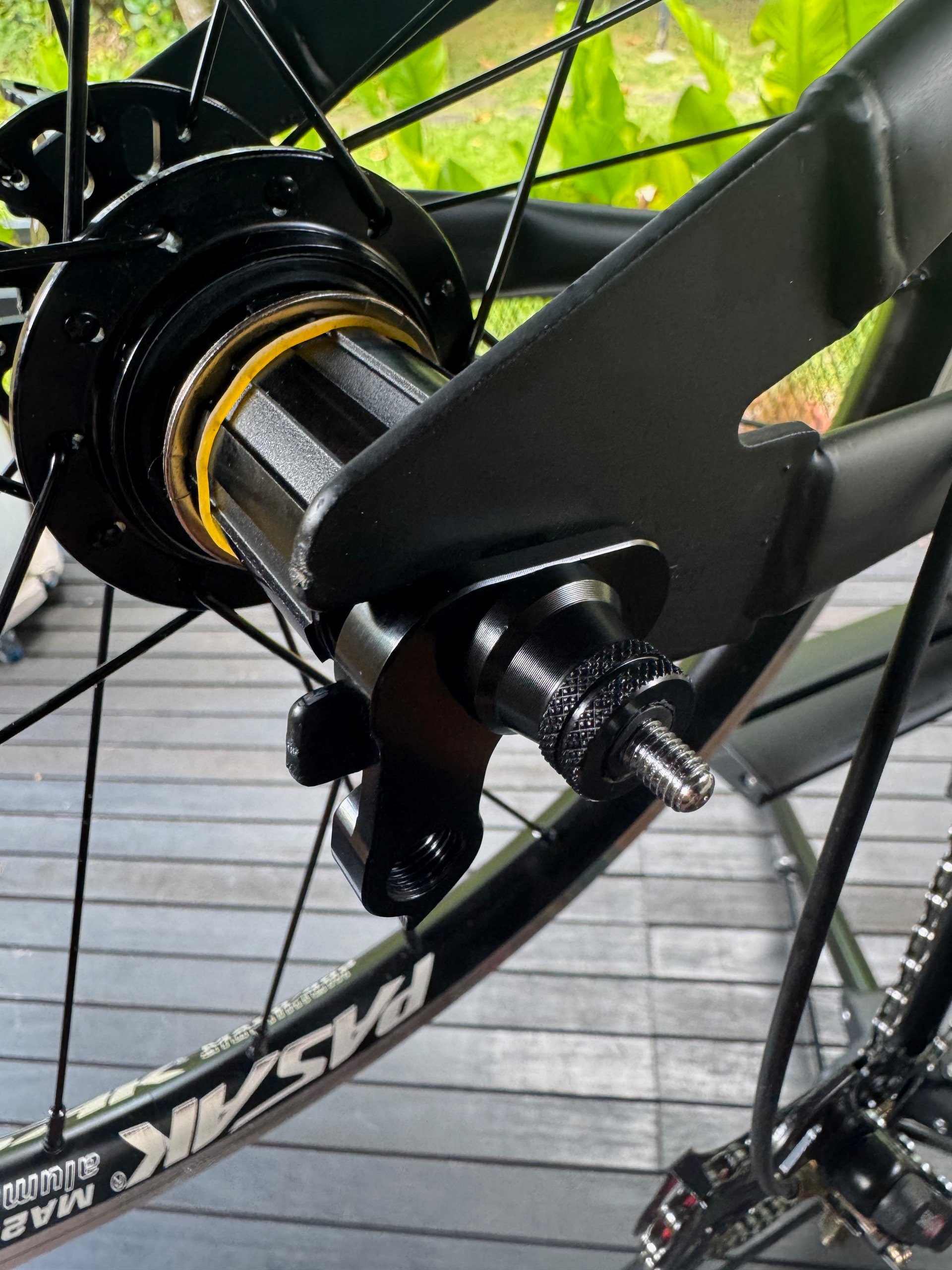

Here’s the view on my bike:
Appreciate any suggestions if there’s a way to solve this.
What do you mean that the quick release won’t close? In the picture, it looks like the overall length of the QR isn’t the issue. Is it that the channel part of the hanger is thicker than the dropout, so there is no clamping force on the dropout when tightened? One could carefully file/grind/machine the hanger so that it is slightly thinner than the dropout.
I had the same reaction as Gregory. What is limiting the quick release from closing?
This makes sense. Yes the right hand side (where the derailleur is) moves a bit.
I’ll try the to carefully remove a bit of thickness, but I suspect it won’t be as good as the nut on the 10mm axle of the old wheel being equally tight on both sides.

The QR works by clamping dropout between the axle nut and the QR surface. Your situation is that the hanger is preventing that.
Rather than grind down the hanger as some suggested try adding thickness to the dropout. Go to your friendly hardware store and get a washer that is thicker than the portion of hanger that is extended past the dropout . Then saw/file/grind a slot in the washer the width of the protruding hanger. This will allow the QR to clamp all of it together. Assuming this works, you could tack it in place with your favorite adhesive (superglue or epoxy would be my choice).
