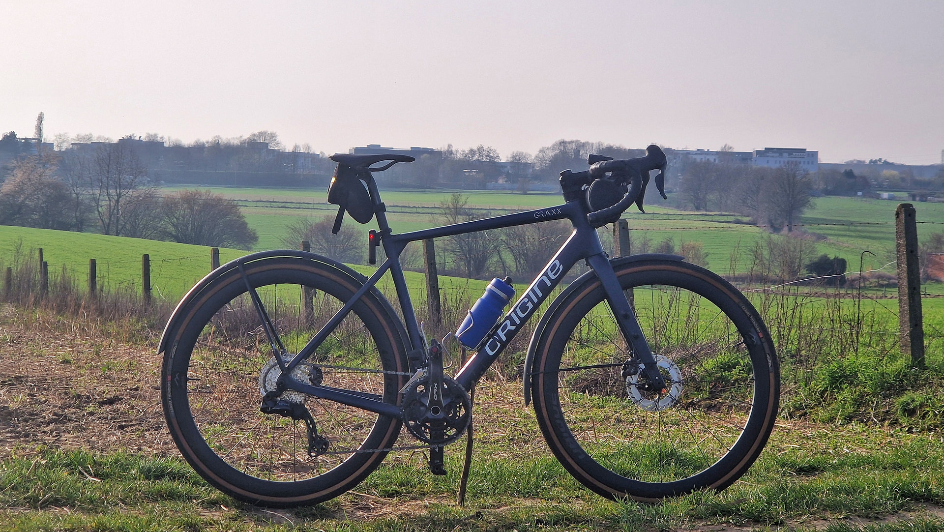

Tufo Gravel Thundero in 36mm, they need to fit in my gravelbike with full heavy duty mudguards.
Labelled width is 36mm on 23mm rims they measure 37mm.
Max clearance is 47mm but of course with mudguards 37mm (measured) is the max.
Love them, fast but haven’t flatted them and for what they are (fast rolling gravel tire) the grip is good and they have been easy to install on at least 3 rims I used them with!
Tufo is not really well know and a bit underrated but everyone should at least try something of them, I also love their roadtires!
