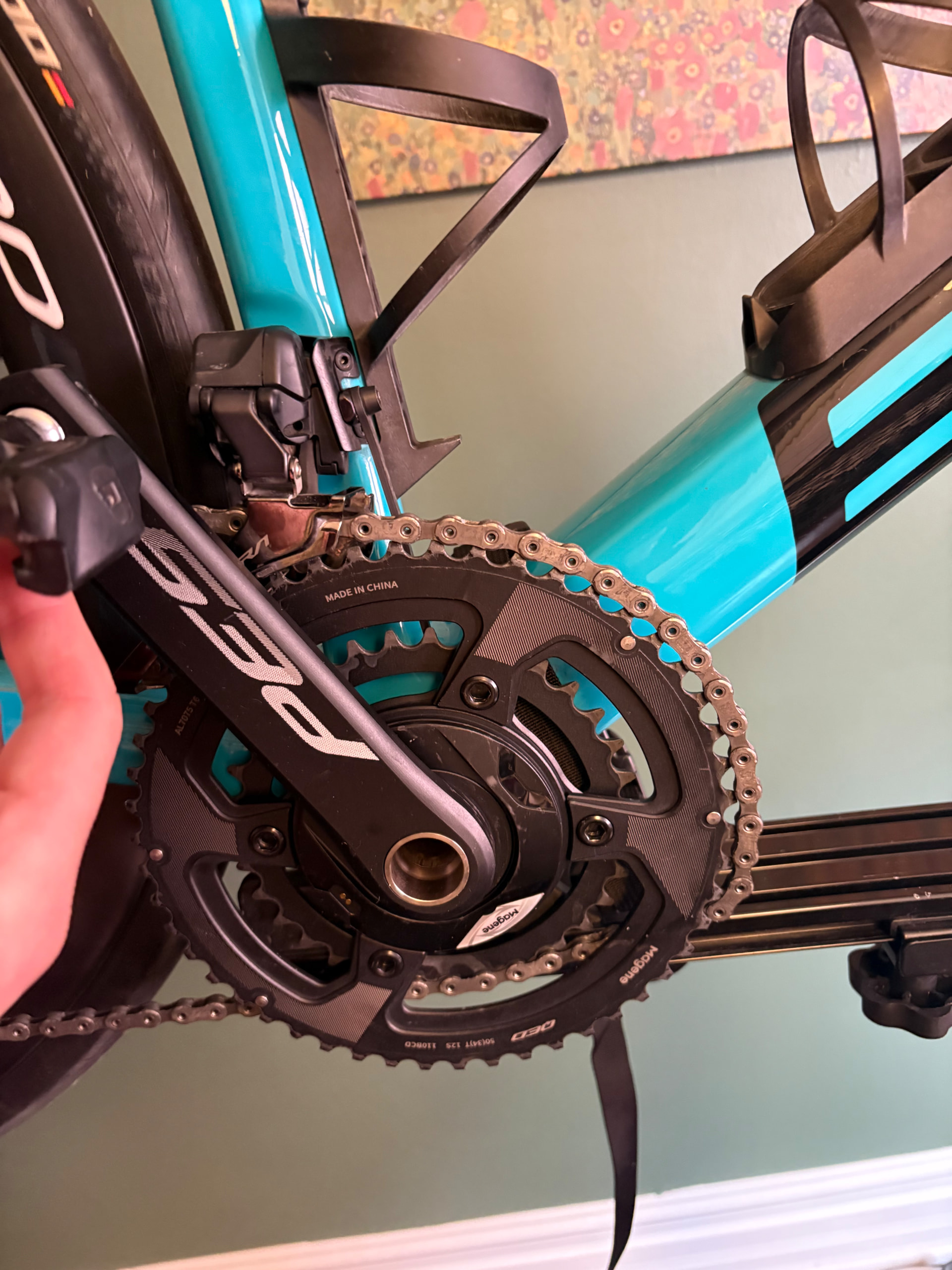

Here is a pic of how it looks before it eventually settles down

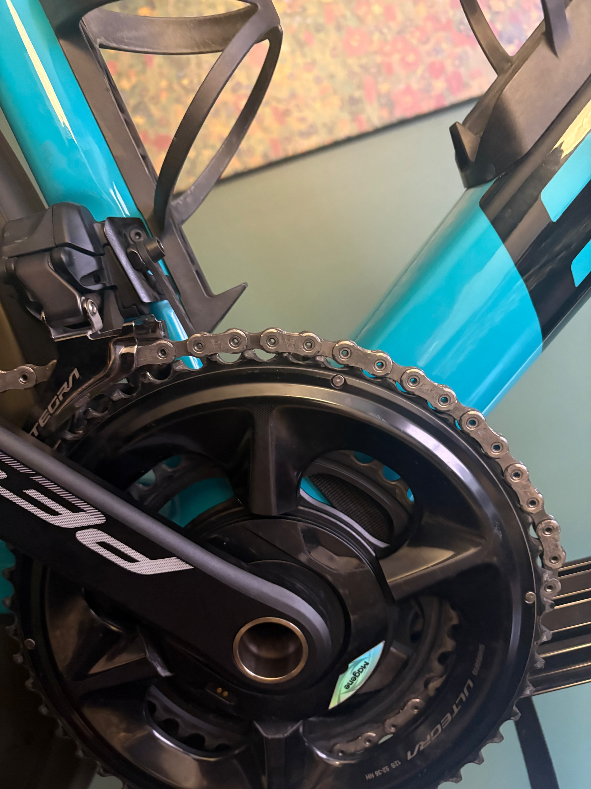

Starting to think the problem is either my FD setup or the spider/power meter itself because I put my old shimano chainrings on the Magene spider/cranks and it’s still happening although to a lesser extent.

Thanks everyone for the help. After fully removing and reinstalling everything I got it shifting a bit better in the stand although not 100%, but I will reserve judgment until I’ve ridden it on the road. Really fine tuning the exact angle of the FD and getting the height as close to 1mm above the big ring without going under seemed to help a bit. The chain is facing the correct direction but I really don’t think it’s a chain issue since it has happened on two different 12 speed shimano chains (one ultegra one dura ace)

An ideal shift is where the chain is fully engaged on both chainrings simultaneously. In the case of the photo above, it looks like an issue with a chainring that is worn with a newer chain. The small chainring is worn so the chain sits in a different spot than it normally would and now the distance between the tooth on the small ring and the tooth where the shift ramp is no longer is a multiple of 1/2” (the length of a chain link).
