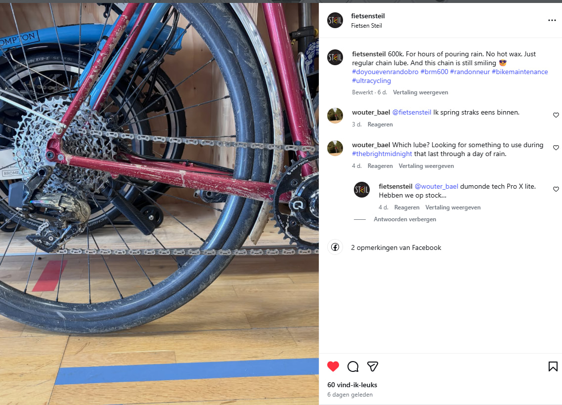

A guy I know who does those long randonneur rides posted this on his Instagram.
The chain lube is Dumonde Tech X Pro X Lite.
I got myself a bottle and going to test it during Bright Midnight.
