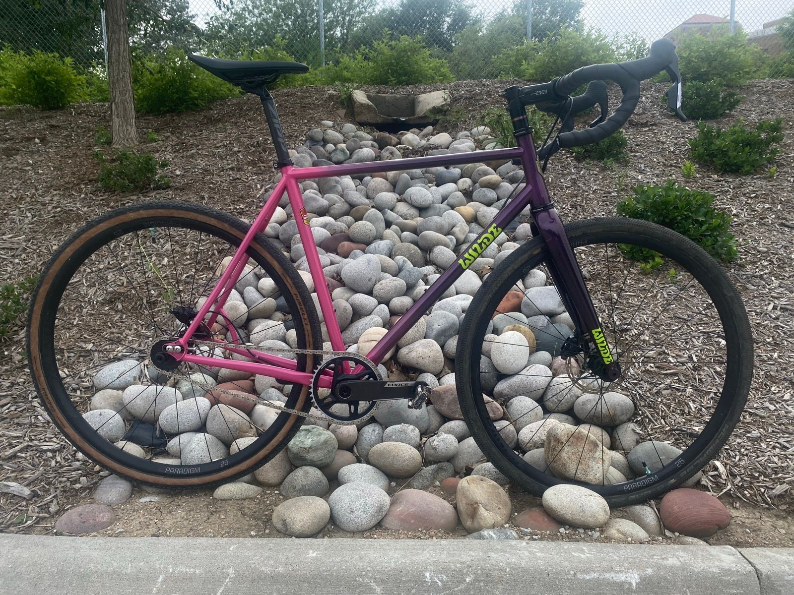

Just built up a new Wilde Mean Jean; it’s a fun little cross bike that can be run geared or singlespeed. I’m running it singlespeed right now, and have the newest AXS Force levers on it, with SRAM bonus buttons.
I’d like to be able to use the buttons with a head unit; e.g. switching pages on a Karoo, or triggering a new lap. Is this doable without a derailleur? The AXS app isn’t recognizing the levers, but I don’t know if that’s a limitation of the app, or if there’s a more technical limitation.
