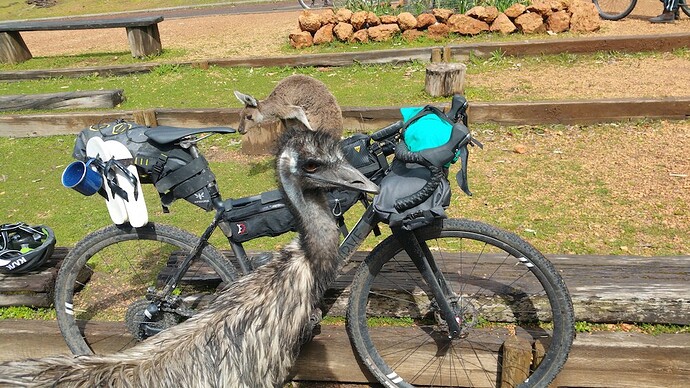

Y’all got me looking back through my photos. That sandy bit down south was SO scenic, and the forest sections are bliss.
In fact my ipad Home Screen is one of my fav photos from that ride. :heart_eyes:
It’s such an awesome ride. :grinning_face:
