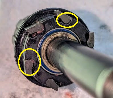

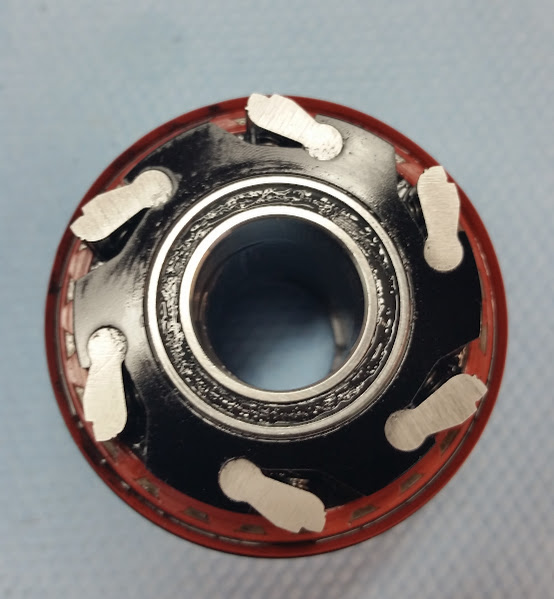

For most pawl hubs (I-9, DT Swiss DEG, etc.) I have observed pawl pocket mushrooming (personal observation was lack of appropriate service) and I have attempted to mitigated this with freehub grease in the pawl pockets. I have this I-9 XD free hub with over 14K miles that show very limited pocket mushrooming.
This next image is not my photo and a different freehub, but his illustrates pocket mushrooming. beyond service life perhaps?
