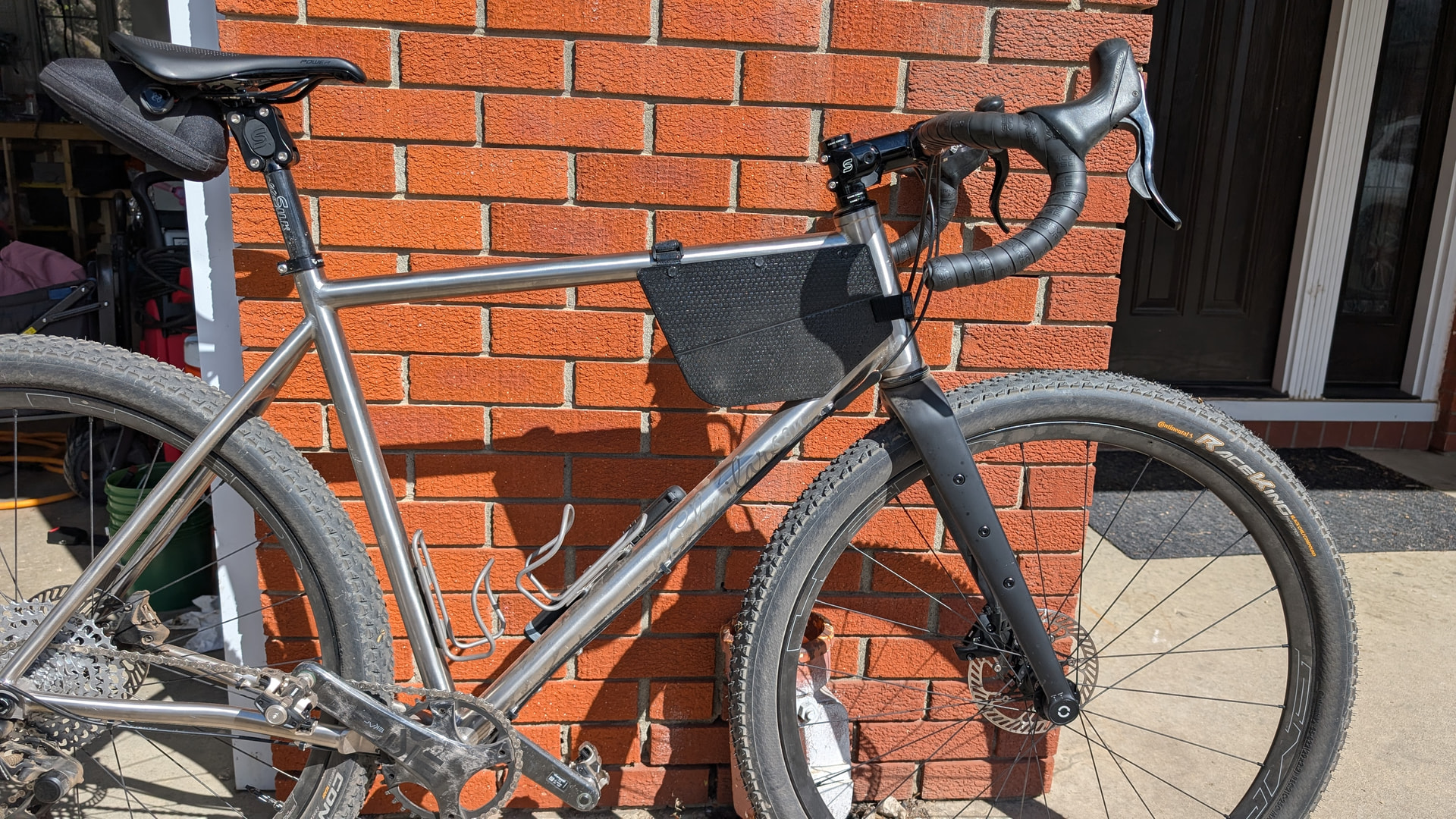

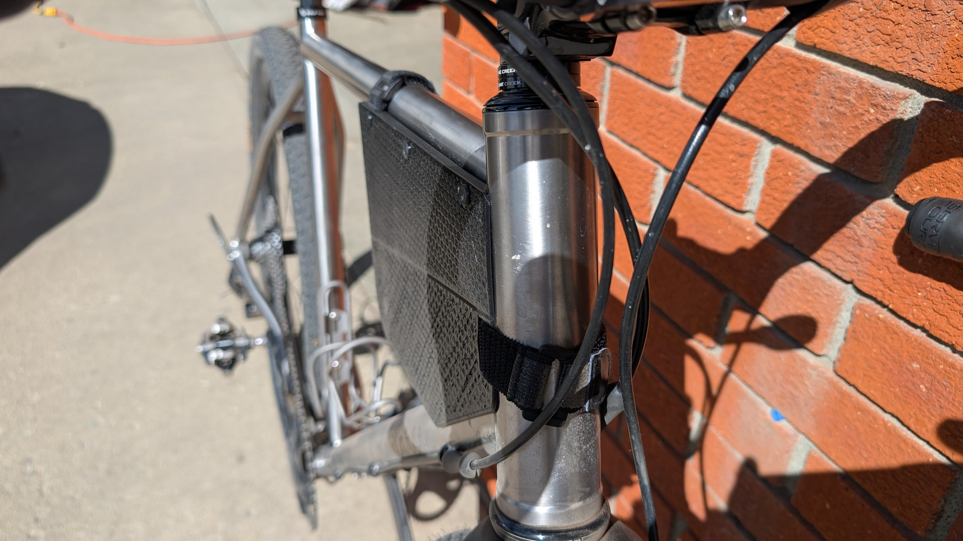

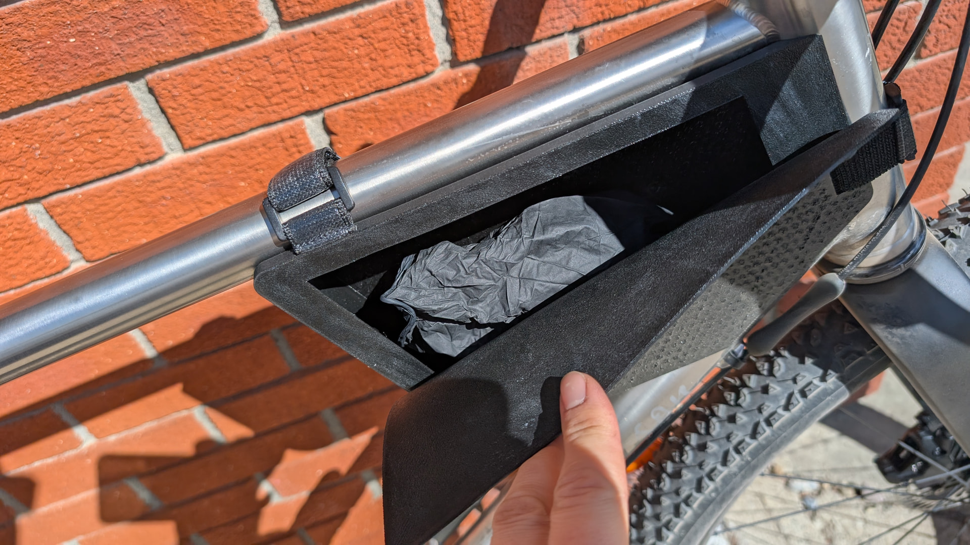

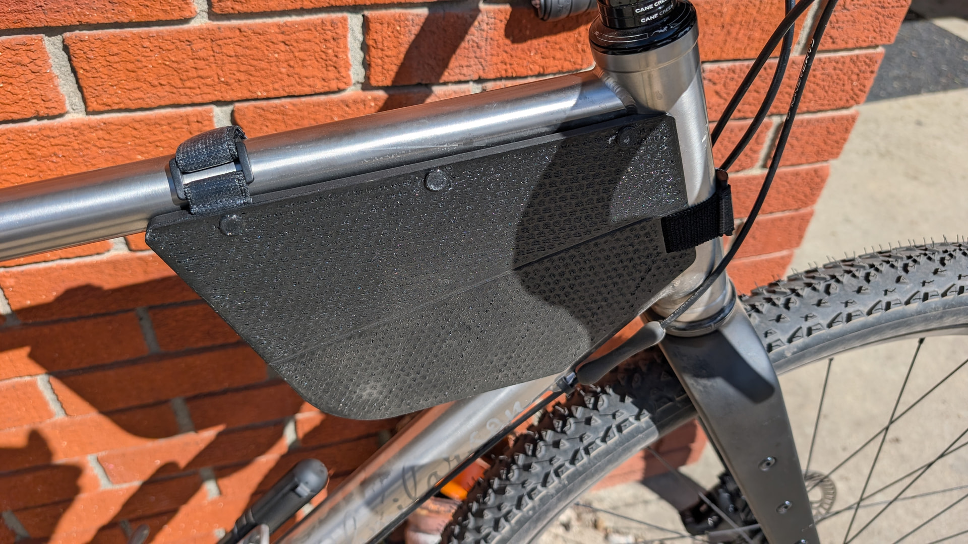

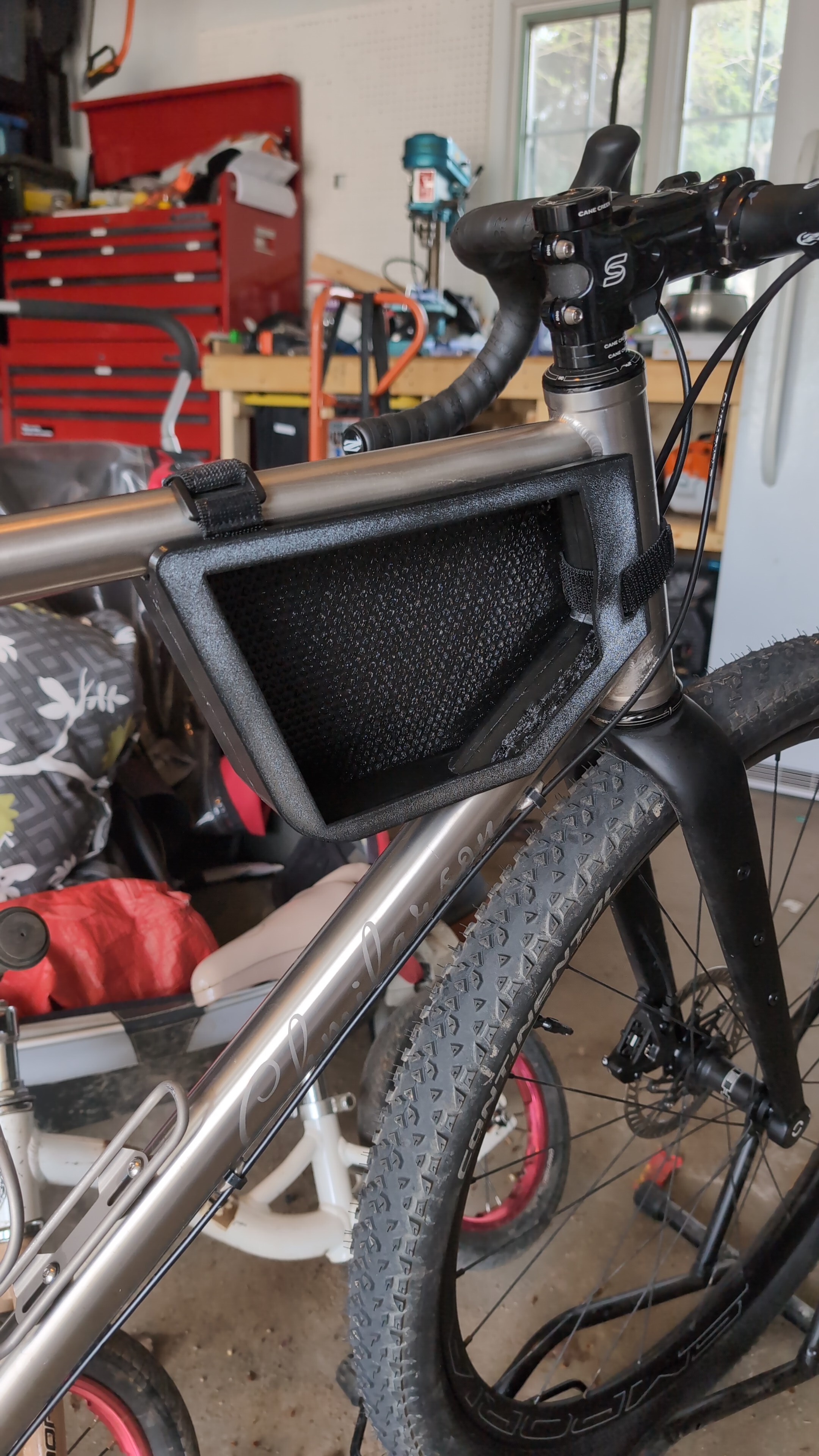

Just wanted to share a fun little project that I finished this week: a 3d printed frame bag for my gravel bike.
Bag is made of 95A TPU, printed in multiple pieces and glued together with LocTite fabric and vinyl glue. Cover is glued on with magnets holding the opening closed.
This is a picture from the initial print, before putting the cover on. I will post more of the finished bag when I get home.

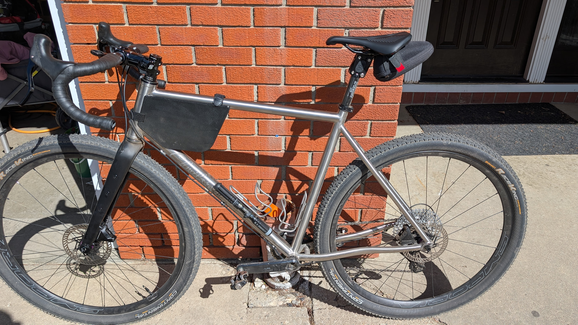

What size is your bike?
The bike is custom, but would be a 58cm or L to XL in most sizing.
I wanted in integrated look, so definitely not universal design.
I originally split the shell into two halves to try to avoid using supports. I don’t have a ton of experience printing TPU so I didn’t know how well they would be removed.
Having built this one, I think I could simplify the process quite a bit knowing how the TPU prints.
