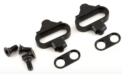

Do the small metal plates that come with the shoes make a difference to this? Is there an option to use a spacer to reduce intrusion of the bolts towards the foot bed? I’d be interested in hearing if anyone has solved this issue

By “small metal plates” do you mean the standard inserts?
No, thankfully i know to put those into the cleat with the bolts on top.
