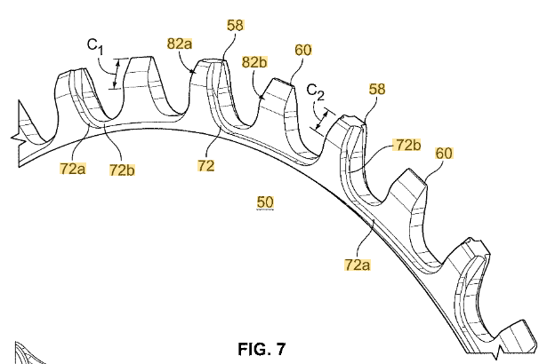

The minimum chain stay length is based in part on tooth profiling. Chainring teeth have all sorts of cuts and chamfers to give the chain clearance when the chain is bent to extreme angles. An aftermarket chainring with different tooth profiles will yield different amounts of clearance so the SRAM minimum chain stay length is irrelevant. In my experience the term “compatible” is used very loosely in the world of chainrings. When it comes to 12 speed drivetrains, especially 1x, I have yet to find an aftermarket combination that is as smooth as full Shimano or full SRAM.
