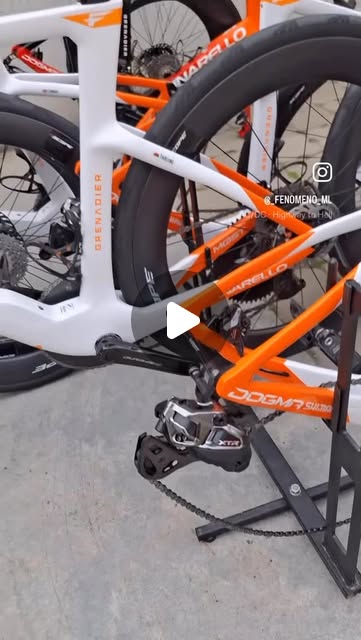

Ineos are running XTR for Roubaix it looks like.
But using a road cassette?
I’m really curious if it works with a road cassette without any further modification (asking for a friend…)

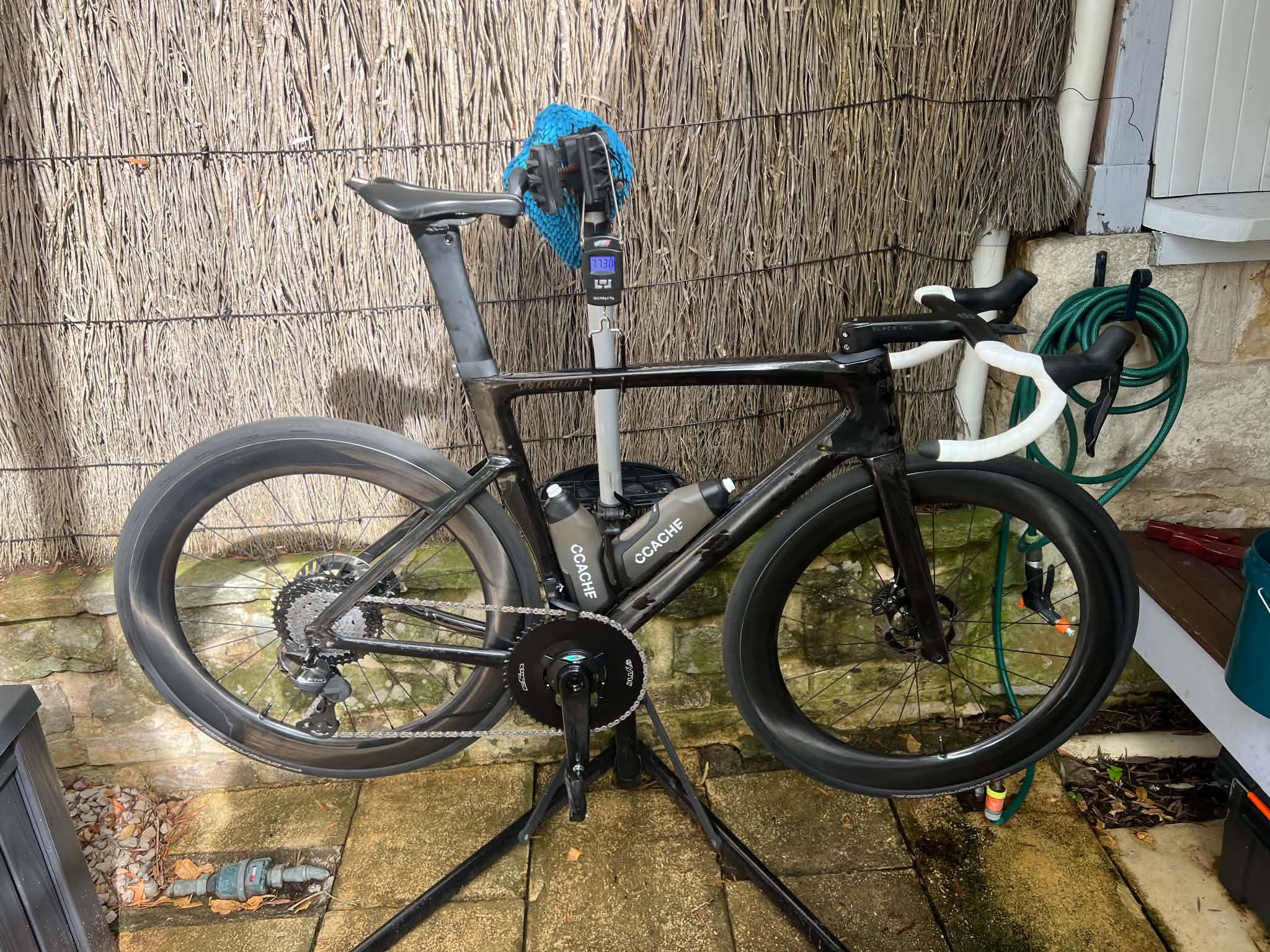

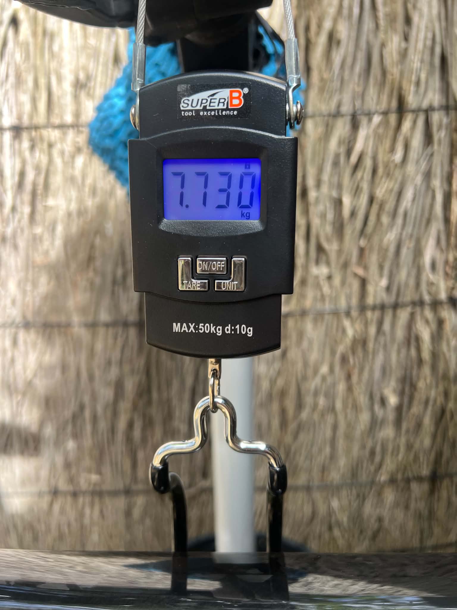

The bike has finally come together, I bumped up the chainring to 58t and after much consideration I went with the 10-45 rather than the 9-45. It’s only added about 200g overall to the bike weight (was about 7.5kgs before the changes).
The weather around Sydney hasn’t been too nice so haven’t had a chance to take it out on the road. But on the rollers the shifting and overall performance was just as fast as the Duraace.

What a weapon, looks amazing.

No input on the gearing. Just want to say that bike looks absolutely insane. Can’t believe that frame is 7 years old, holds its own against today’s bikes imo!
What are the wheels on the Venge?
Also kudos for choosing the Black Inc. handlebars—their angularity really matches the bike’s!
